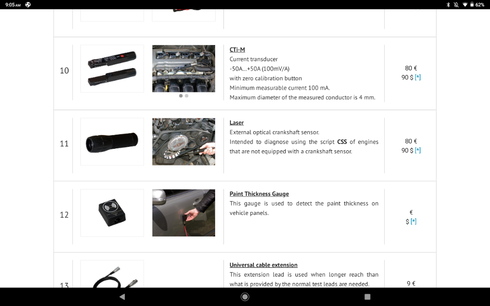

You CAN  add your own scripts, no problem there. Even the existing scripts are open source.... The optical sensor is offered on the USB-Autoscope site. You also can look on Amazon, ebay etc for optical sensors but be aware that you'll gonna need a high resolution signal: the typical :one magnet: design with one pulse per revolution will not work..

The necessary hardware for Andrej Shulgin scripts were developed in a close relationship with USB autoscope, actually they are the authorized "partners" to employ his scripts. You could make your own adaptor from XLR to bnc if you don't want to buy a commercial one.
As the script works with any high resolution speed signal from any car I see no problem there.
Although working quite a bit with the CSS script I do not consider an rpm sensor an essential, necessary item.....there are almost no cars out there where I needed to apply this. Your local market may be different though.

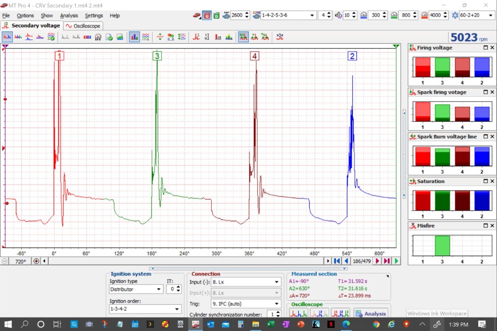

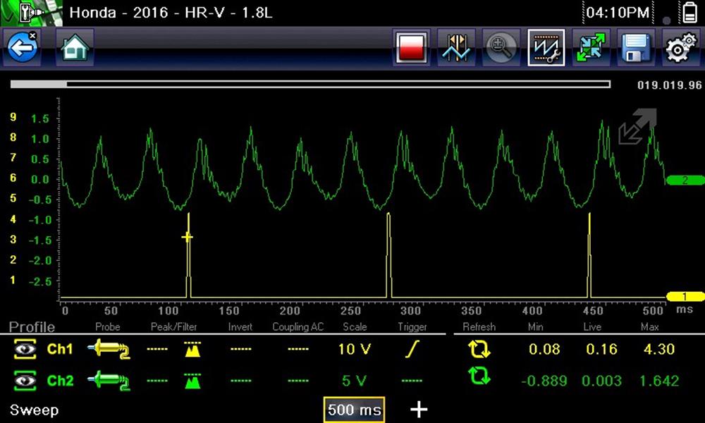

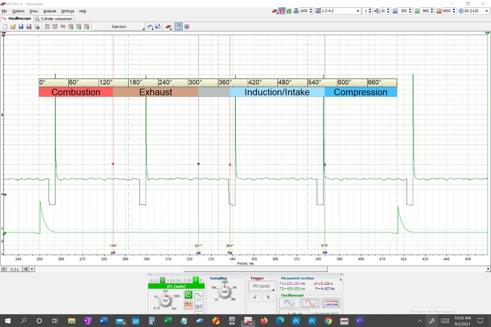

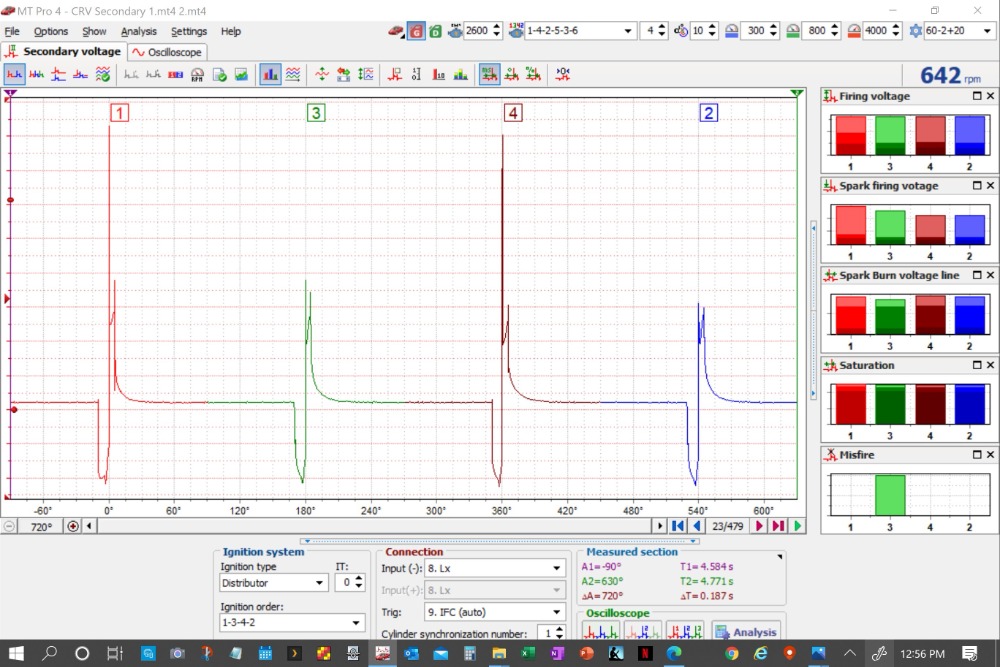

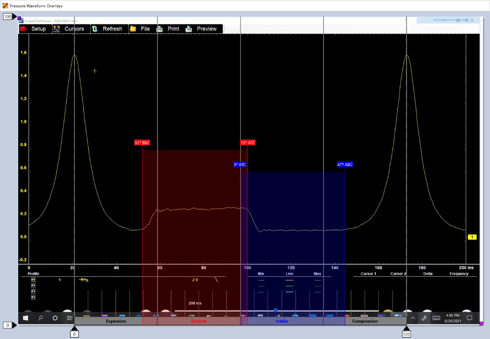

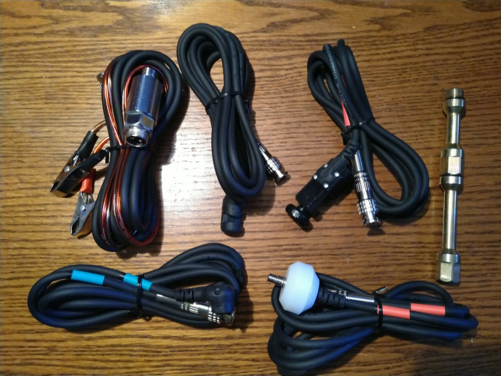

So... I bought a MT-PRO 8 channel scope, and an in cylinder PSI Transducer from Rotkee (haven't used it on the MT-PRO yet sorry), along with the Rotke pressure Delta sensor. I bought them in the beginning of the summer along with the mixer test leads for ignition and injectors.
The process of buying these things from The Ukraine was a bit complicated and albeit scary, but following Rotkee's directions using Wise money exchange etc... worked and I got my items in around a months time with no issues. All and all the cost was under $600.00 for everything which also included a number of their test leads and back-pinning probes. As far as I can tell a similar setup from Pico would be 10 times the cost..... I love Pico's software but as a dealer line tech It's just not in the cards..
I am relatively rusty at scoping as I stopped using my Fluke Labscope around 15 years ago (long story) but I have to say the Rotkee software in English is very intuitive...
Particularly interesting is the ability to scope injectors and ignition coils at the same time in sequence with the mixer cables, you vcan get both ignition and injector patterns in parade format with a separate synch, and use their analyzer app with rpm calculated for you... Amazing!
Please forgive me if the following jpegs don't work I will try to figure out how to post them if they fail..
Also I share everybody's sentiments in regards to a stand alone scope like a Vantage/modis and a P/C based scope, if you are working flat rate like me breaking out a P/C based scope in the work day with shop bay space etc is really a rabbit hole situation... set that stuff up and POOF time just evaporates into thin air like a bad A/C leak..
ok here goes... Ignition parade
Injectors on parade with a ruler just for kicks
Rotkee In cylinder on a Snap-on Modis
rotkee Delta sensor cranking (i think)
and finally a second ignition at 5krpm with fuel cut
Last edit: 4 years 11 months ago by wowcoop. Reason: wrong atachments and spelling
