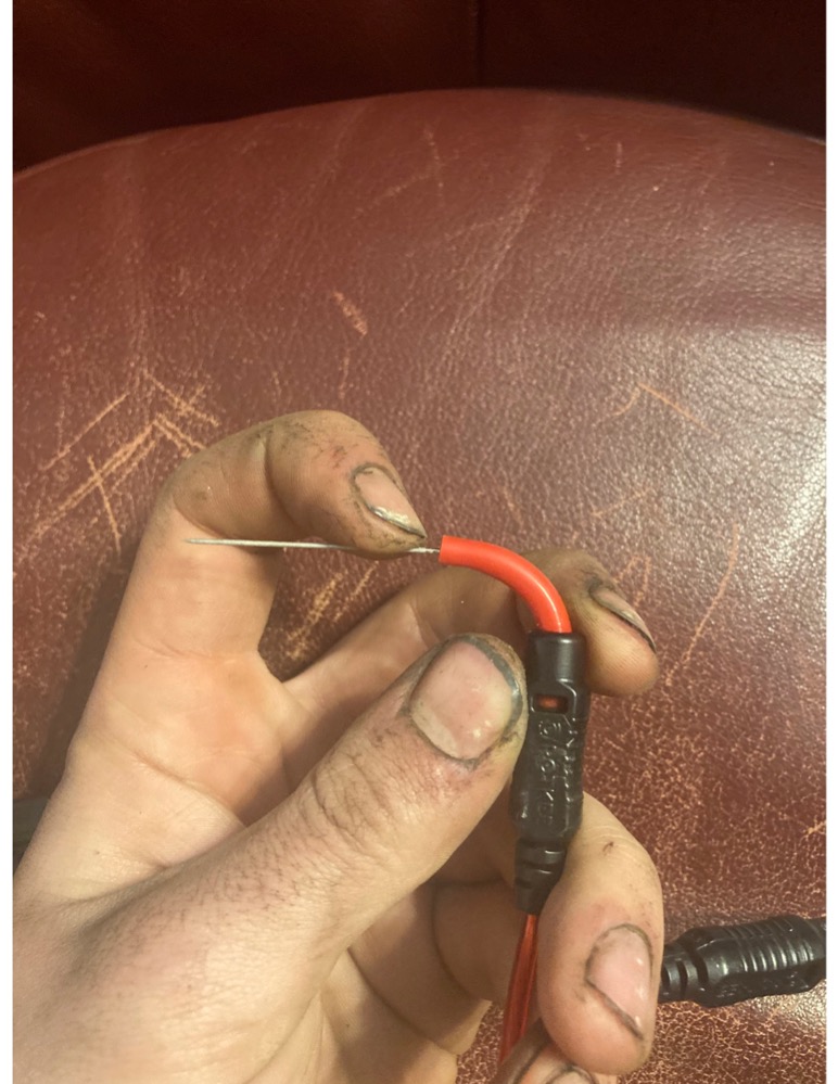

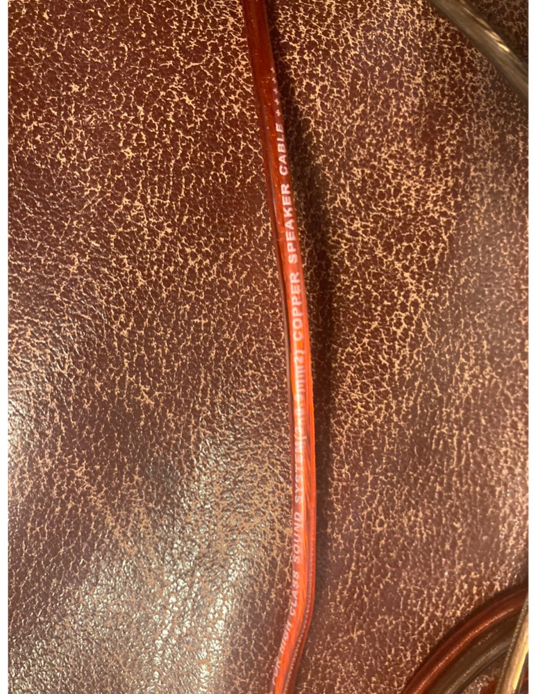

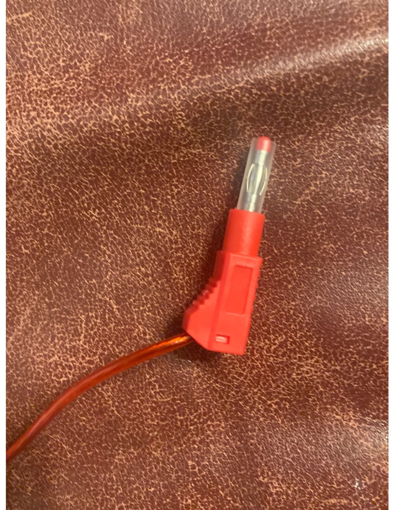

5 years 7 months ago #47315 by AJeep18
Replied by AJeep18 on topic Re:Rotkee vs. Pico
I ordered some 6ft Banana back probing leads a couple of weeks ago and got them in the mail today. Seem ok. The wire is speaker cable though... no too impressed by that. I like that the tips are flexible. Eagerly awaiting your review of the scope Tyler!
5 years 7 months ago - 5 years 7 months ago #47316 by AJeep18
Here is what the look like [attachment=9086]
