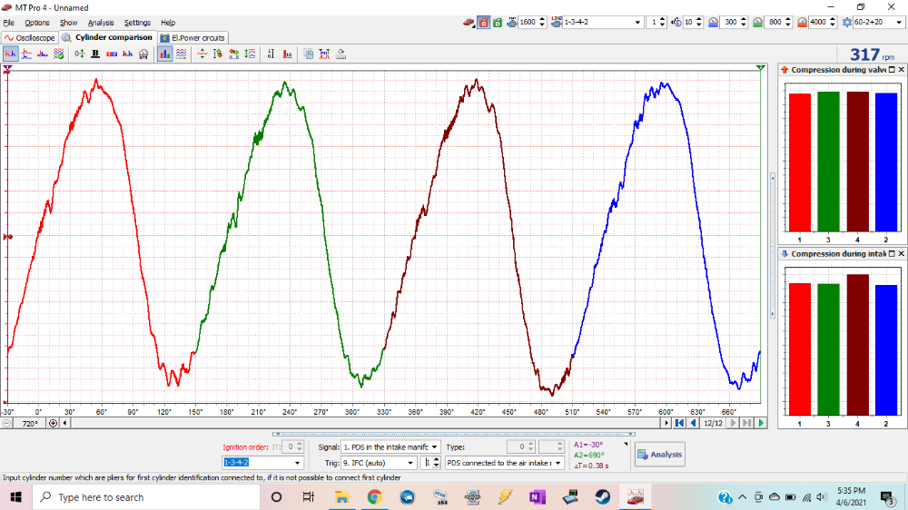

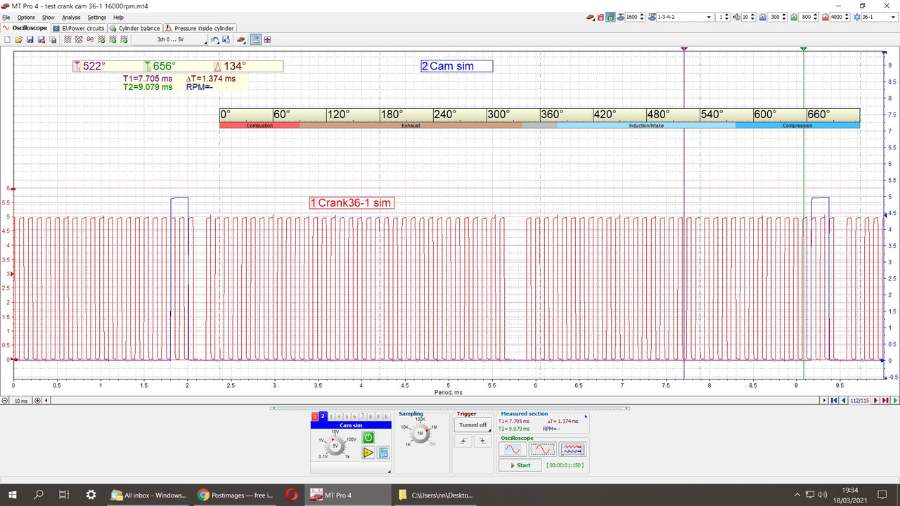

5 years 7 months ago - 5 years 7 months ago #47572 by stevieturbo
Replied by stevieturbo on topic Rotkee vs. Pico
This is a test of crank cam from a simulator...I had thought initially it was 9000rpm, but it's actually 16,000rpm. So still a good clean waveform at that, 36-1 with a single tooth cam.

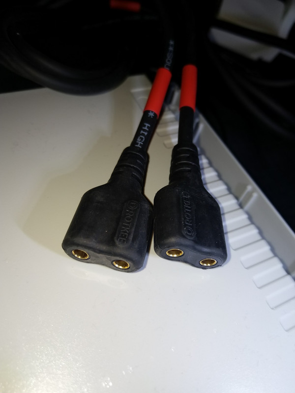

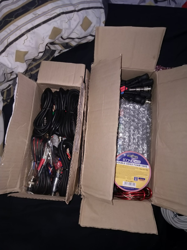

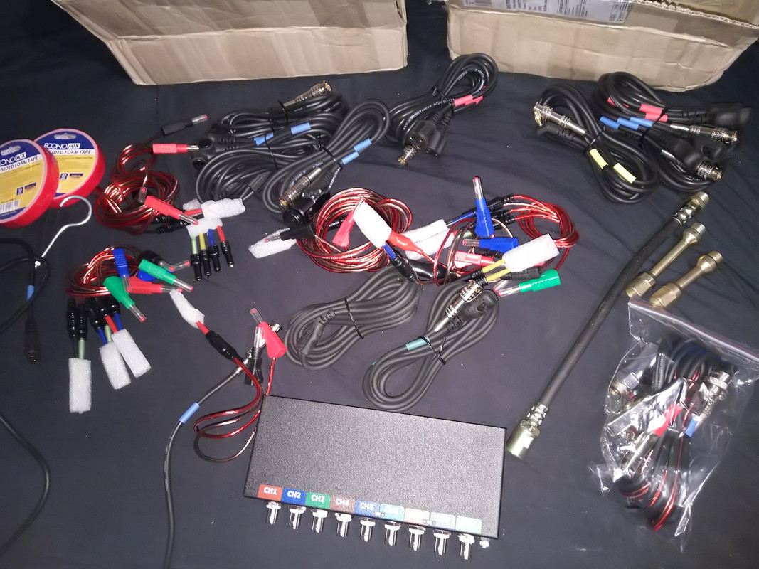

And the selection of stuff. Have to say the quality seems very good, even the moulded rubber parts of some connectors have Rotkee embdedded in them. A more distinct +/- marking at those specific banana sockets would be nice, but it is printed. A dab of paint will sort it though.
But as others said, the shielded banana plugs are nice, and in general quality seems good, especially considering the low cost.
Must admit...the connectors I ordered with a single BNC, but either 3 or 4 terminals ( like this pictured with two pairs ), haven't a clue what they're for. I guess they're just splitting for measurement of two things at same plug, that occur at different times. Either way, quality of them is good.

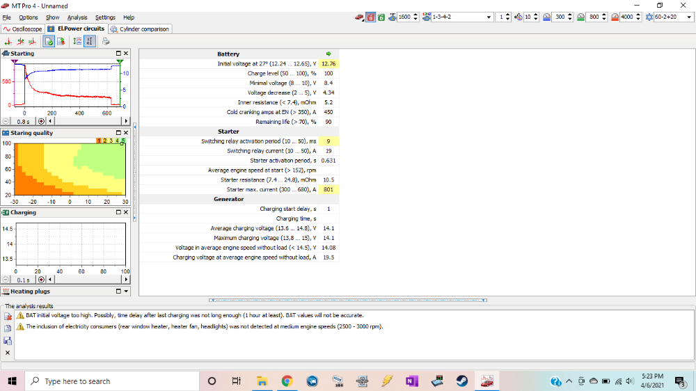

I tried scoping current and voltage of a little battery tester that performs a discharge test on small 6/12v batteries as I wanted to see what it was doing.
In the time of around 60ms it performs multiple load tests on the battery ( this one was deemed flat though, small 12v 7Ah battery ) even though no load it registers 12.38v

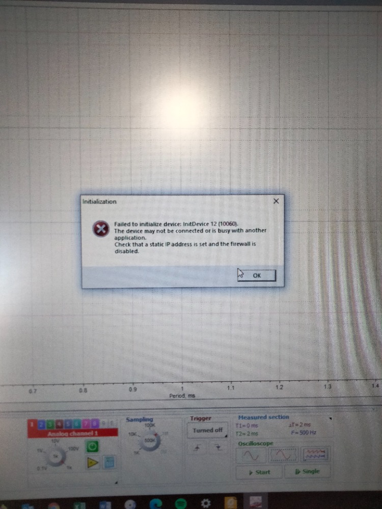

5 years 5 months ago #48737 by vb4me
Replied by vb4me on topic Rotkee vs. Pico
Has anyone else had this message.
Haven't been able to try mine out yet.
5 years 5 months ago #48738 by stevieturbo
Is that not the error you get when it is not plugged in and powered up ?
5 years 5 months ago #48739 by vb4me
I can open up the software but when I plug in the scope this is the message that pops up.
5 years 5 months ago #48740 by stevieturbo
are you plugging the scope in and powering it up before opening the software, or after ?
needs to be powered up etc before.

5 years 5 months ago - 5 years 5 months ago #48763 by vb4me
stevieturbo I have 5v at the connector. No lights on rear of unit. unplugging then reinserting the plug results in a yellow and a green LED lighting up briefly then going out. Sounding like a faulty unit?
It does this with the LAN cable plugged in or out.
