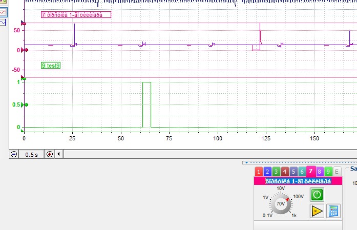

For the Rotkee/MTPro software....I was trying it yesterday, on the channel names, the first channel is some russian symbols. Does anyone know how to change the cannel names ? You'd think that should be easy, as the others have normal names.
5 years 8 months ago #46947 by Matt T
Replied by Matt T on topic Rotkee vs. Pico
stevieturbo wrote: For the Rotkee/MTPro software....I was trying it yesterday, on the channel names, the first channel is some russian symbols. Does anyone know how to change the cannel names ? You'd think that should be easy, as the others have normal names.
Hold down right mouse and drag across the text to select it. Then you can overwrite it. Can also copy it and paste it into translate if you want.
5 years 8 months ago #46948 by stevieturbo
Replied by stevieturbo on topic Rotkee vs. Pico
Ahh, good stuff, that was easy after all !
