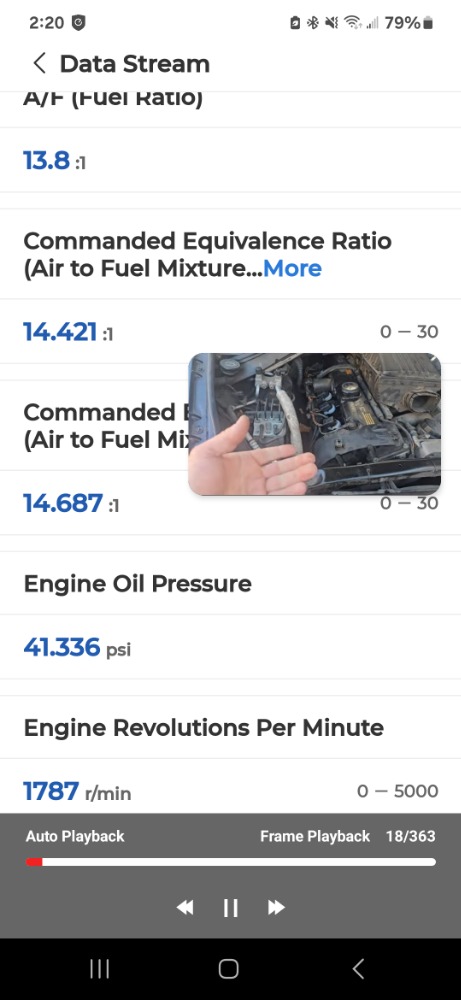

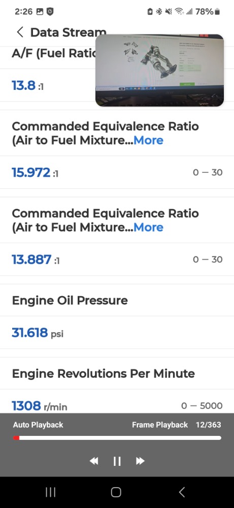

Here is an image of what I'm talking about on top.
There may be something else going on at the time you took that screencap. There's a difference between the commanded equivalence ratio PIDs. One bank is 13.349, the other is 12.649. Maybe this was taken during changing load conditions? Maybe the PCM was running an invasive emissions test at the time.

So yesterday the air fuel ratio pid showed 13.8:1. It stayed at that number the entire drive. The commanded and what the upstream o2 sensor was reading of course was moving up and down. What does this specific pid represent? Is it what the computer is wanting air fuel ratio to be? Pid at the top of the image is the one I'm referring to.
2 years 6 months ago - 2 years 6 months ago #65470 by bills4065
Replied by bills4065 on topic F150 No code intermittent misfire issues
Tested 2014 F150 for issues yesterday. Commanded and equivalence all good. microamps reading as should with heavy acceleration and fuel cutoff. pretty much as Tyler's post earlier.This vehicle problem is a vacuum leak. I used a launch CRP scanner. I know you said you have another scanner. Try it -see what it says.I do not think computer wants the air /fuel ratio to be at 13.8:1 My opinion only. Forgot to add but may be some good info for someone someday.   On decel the following: Commanded EQ ratio 12.44 :1, EQ Ratio (Lambda) 2, EQ (Lambda) Bank 2, Sensor 1(:1) 29.28:1, Exhaust Gas Oxygen Sensor Current Bank 2 Sensor 1 (uA)  2519.5 uA.

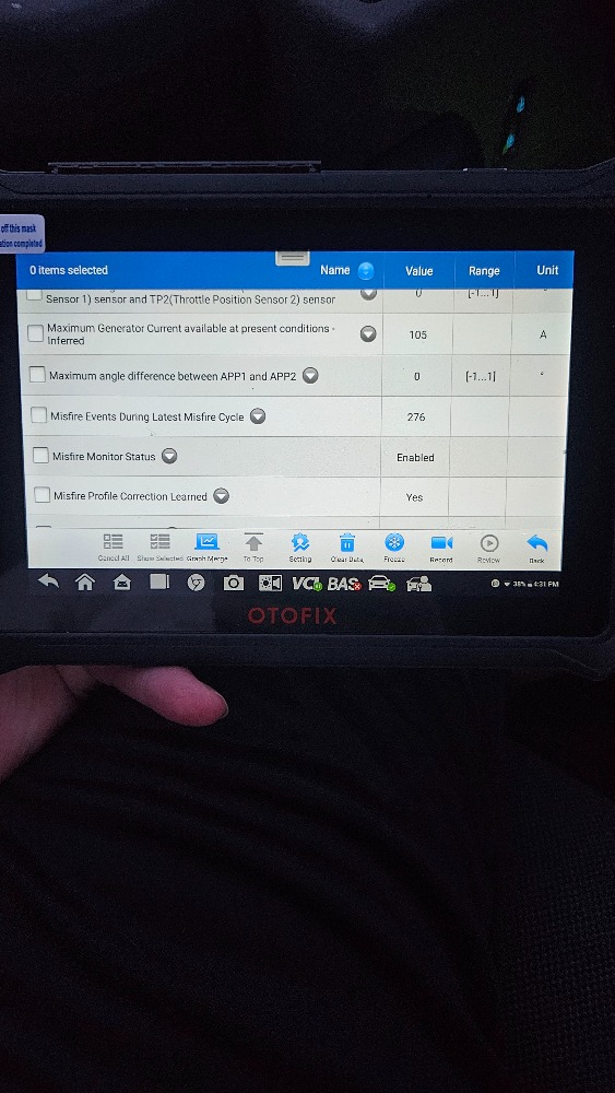

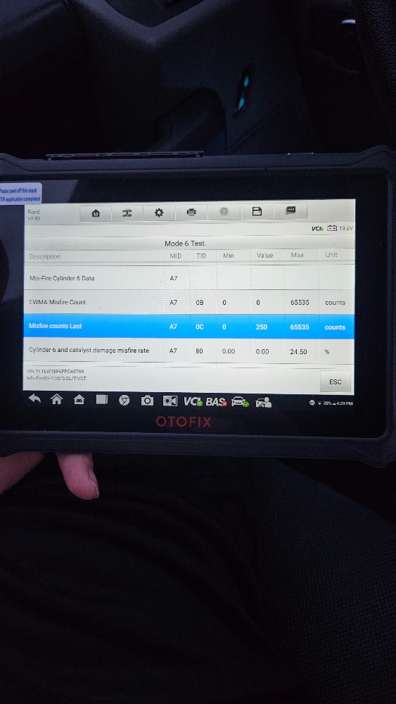

I'm going to share 2 images one of mode 6 data. You'll see the amount of misfires registered during that drive cycle and the mode 6 data will show the amount on cylinder 6.
Since my issues first started cylinder 6 has always had the most misfires.
What I'm leaning towards currently is an intake manifold leak just on cylinder 6 or a possible valve issue. The intake manifold on this truck has individual gaskets per cylinder
I know typically vacuum leaks show up worse at idle. Is that the definite rule or can it be different with a MAP sensor controlled vehicle with an intake manifold like that?
Any input appreciated.

Holy miss counts!   You're onto something with the #6 miss. Have you done a crankshaft variation learn?
The 13.8:1 AFR totally makes sense now. It's the PCM changing the mixture on bank two in response to a misfire. Fix the miss, fix the AFR.
Besides plugs, have you changed anything else?

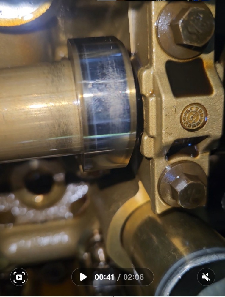

2 years 4 months ago #65942 by 52Tele
Replied by 52Tele on topic F150 No code intermittent misfire issues

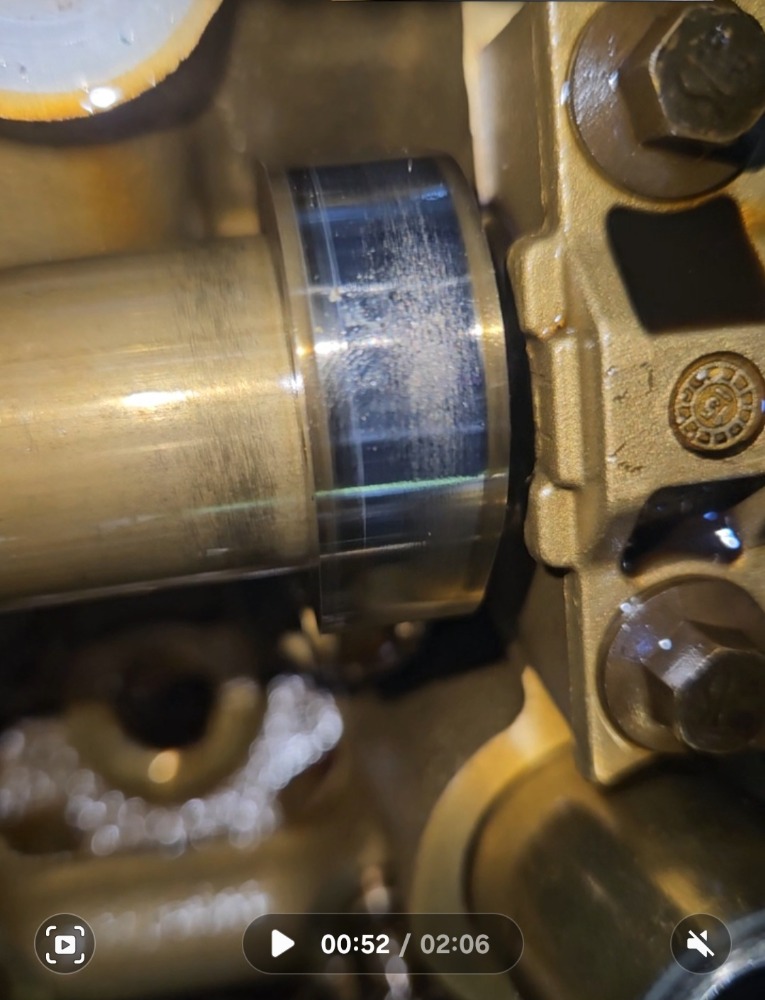

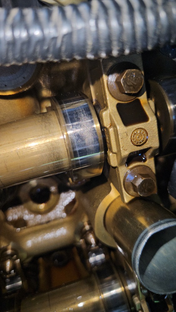

That is what I'm trying to accomplish is fixing the no code intermittent misfire. The problem is being hard to diagnose though and that's why I reached out here.
I ended up replacing bank 2 VCT solenoids about 2 weeks ago and it helped the desired minus actual data pid readings on bank 2. Unfortunately the misfires are still happening. I took a picture of the intake camshaft on bank 2 the cam lobe in the picture has scratches that can be felt with my finger nail. Those scratches are on the intake camshaft at cylinder 6 which is where my misfires are happening. Anyone have any input?
