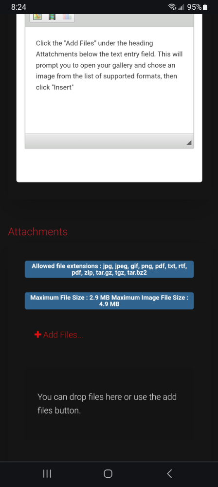

2 years 7 months ago - 2 years 7 months ago #64897 by 52Tele
Replied by 52Tele on topic F150 No code intermittent misfire issues
Is there a way to share images on here? I was going to share a screenshot of the crazy fuel trims I had a little bit ago.

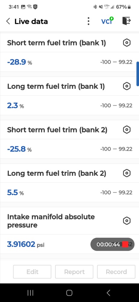

OK thanks. Today while at lunch in the truck in park with ac on I had really rich fuel trims anywhere from -10 to -28.79.
2 years 7 months ago #64906 by Noah
Replied by Noah on topic F150 No code intermittent misfire issues
Click the "Add Files" under the heading Attatchments below the text entry field. This will prompt you to open your gallery and chose an image from the list of supported formats, then click "Insert"
When you do post the screenshot of the fuel trims, please be sure to include long term and short term fuel trim for both banks along with RPM and fuel system status (open loop/closed loop). Excluding any of those PIDs will make it very difficult to gauge total trim.​​​​

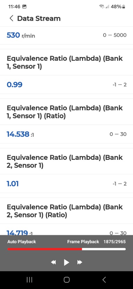

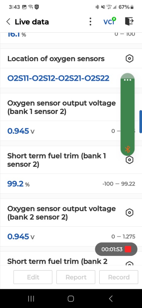

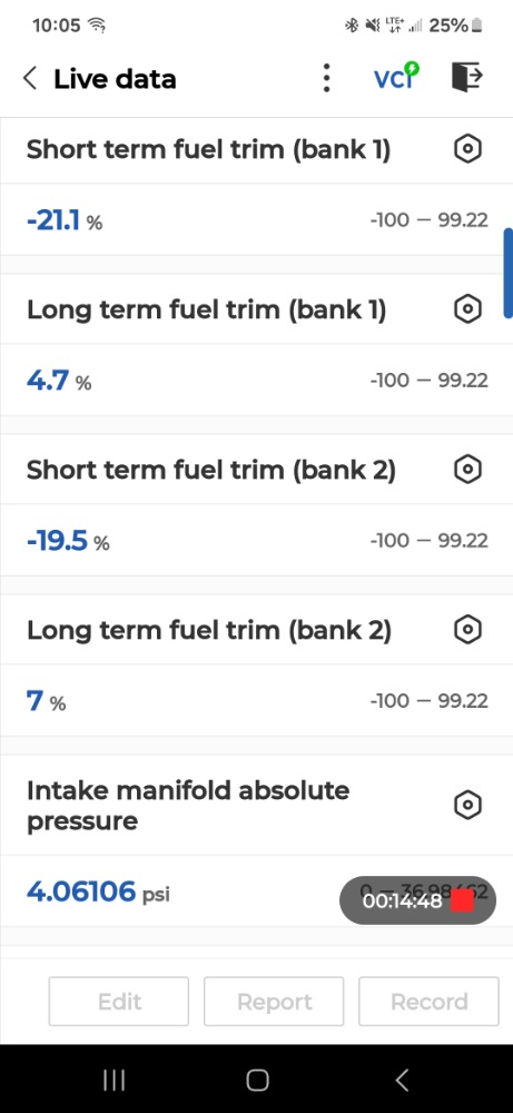

2 years 7 months ago #64910 by 52Tele
Sorry the rpm wasn't on there but these were at idle. Twice after pulling up and stopping at a red light. And the one with short term trims of  -21.1 bank 1 and -19.5 bank 2 that screenshot was at lunch parked with ac on. Rpms were anywhere from 530-600
2 years 7 months ago #64913 by bills4065
Replied by bills4065 on topic F150 No code intermittent misfire issues
Here is where you are at: at idle both stft taking fuel away,- both downstream O2 sensors at .950 volts do suggest rich. What were the upstream O2 sensors reading? At 3469 rpm both banks are running lean. Noah's suggestion of pids to monitor great idea. Your idle readings were taken in closed loop. Has truck had an oil change lately?

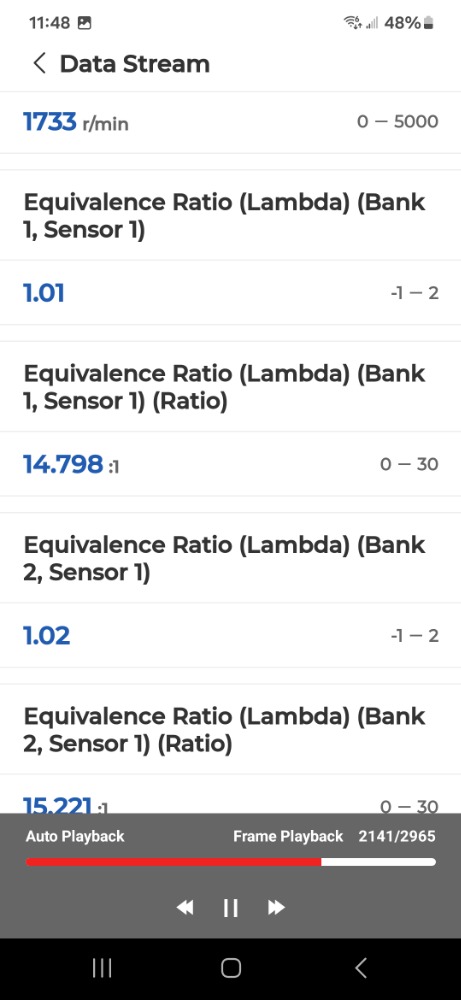

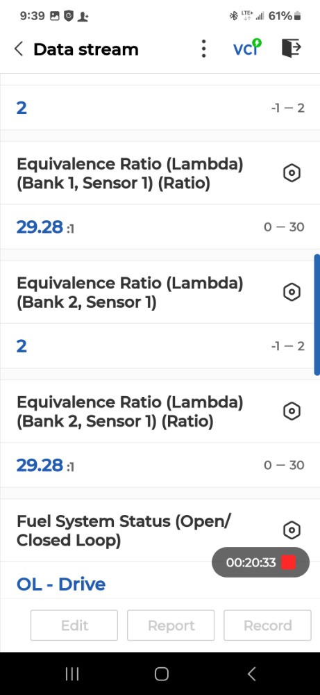

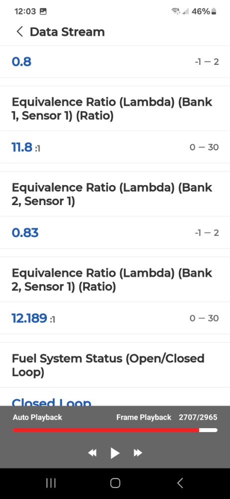

I'm going to post a few scanner images from a drive a little bit earlier as well.
Also the map sensor on the trucks reads the manifold pressure as well as intake air temperature. Tonight I noticed intake air temp up to 109.4 at idle and 98.6 just normal driving with throttle partly open. The outside ambient temp at the same time as those readings was 57 degrees Fahrenheit. Is a gap that big normal between ambient and intake air temp?
  • 52Tele

This was while doing a deceleration coast.

This was a random idle capture of rpm and upstream data.

Another random capture at 1733 rpm while driving.

2 years 7 months ago #64926 by 52Tele
This is right after going back into closed loop from a deceleration. To me this doesn't seem normal but again trying to learn more if I'm wrong. The rpms were 931.
