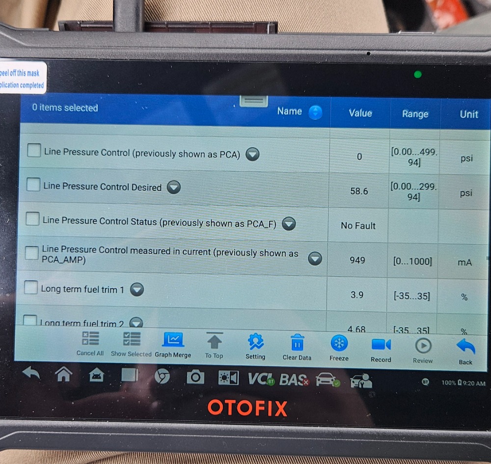

2 years 7 months ago #65028 by 52Tele
Replied by 52Tele on topic F150 No code intermittent misfire issues
So I have pids marked as line pressure. But I don't think it's fuel related. But it's also strange that desired and actual is different on whatever it is.
  • 52Tele
  • 52Tele's Avatar Topic Author
2 years 7 months ago #65031 by 52Tele
I found that this is for transmission.

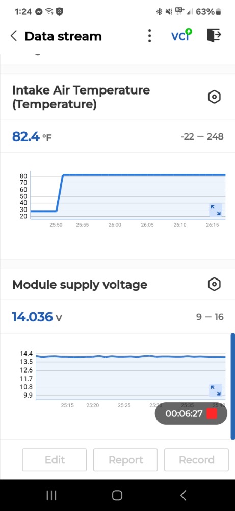

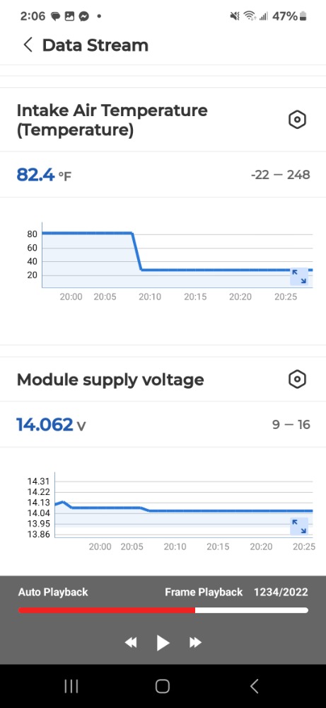

Actually according to my Topscan it's still doing the weird temperature thing. See picture for intake air temp and it also shows the range.
I just luckily caught this
  • 52Tele
2 years 7 months ago #65049 by 52Tele
Here is another image with how long it lasted. Less than a second notice how flat the module supply voltage gets also. Really weird.

2 years 7 months ago #65050 by 52Tele
I actually got the time wrong on that sorry. Let me do some more checking on this when I get my better scanner after work

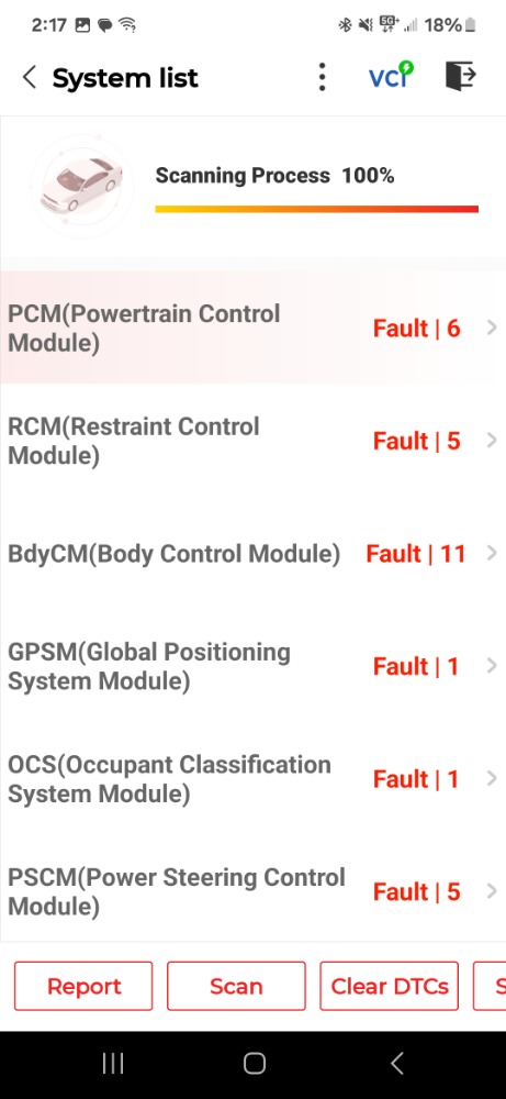

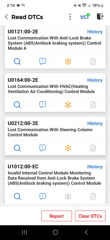

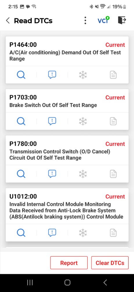

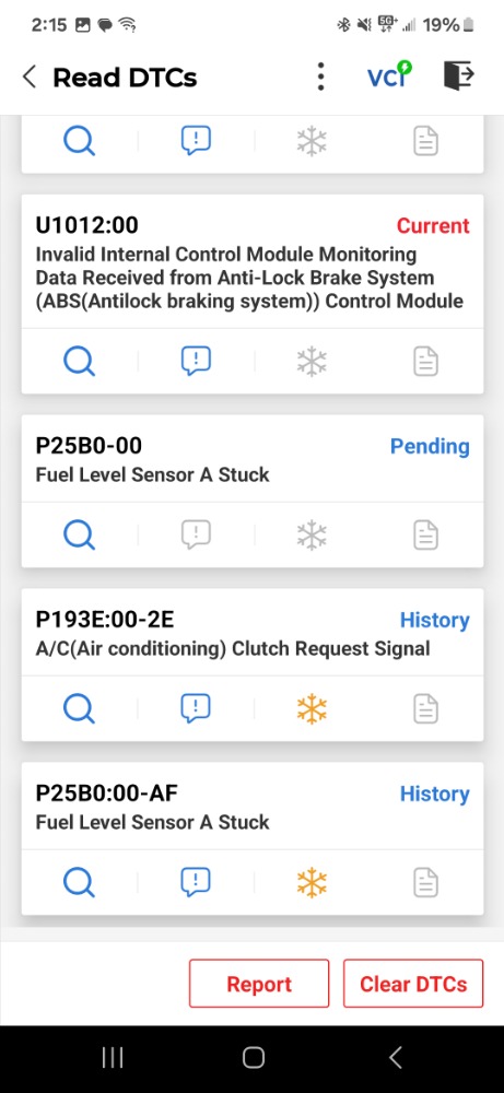

2 years 7 months ago #65067 by 52Tele
So I had something happen that stressed me out even more about my truck. We went to a few estate sales earlier. At the last one we got back in the truck started it and put it in drive and noticed the indicator in the guages didn't move. I moved it back to park an then again to drive. Indicator still didn't move and I realized the whole dash was out. I started connecting scan tool and turned truck off and then back on and it started fine. Shifted again from park to drive and still nothing. Went back to park left it running and while running scan about a  minute later the dash came back on. Ran a scan and this is some of the first things I got.
