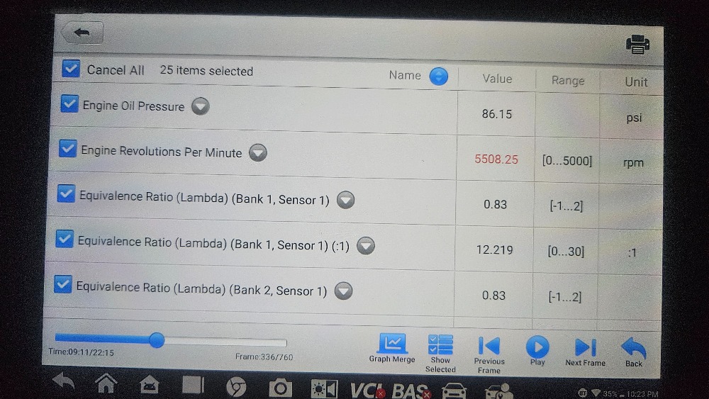

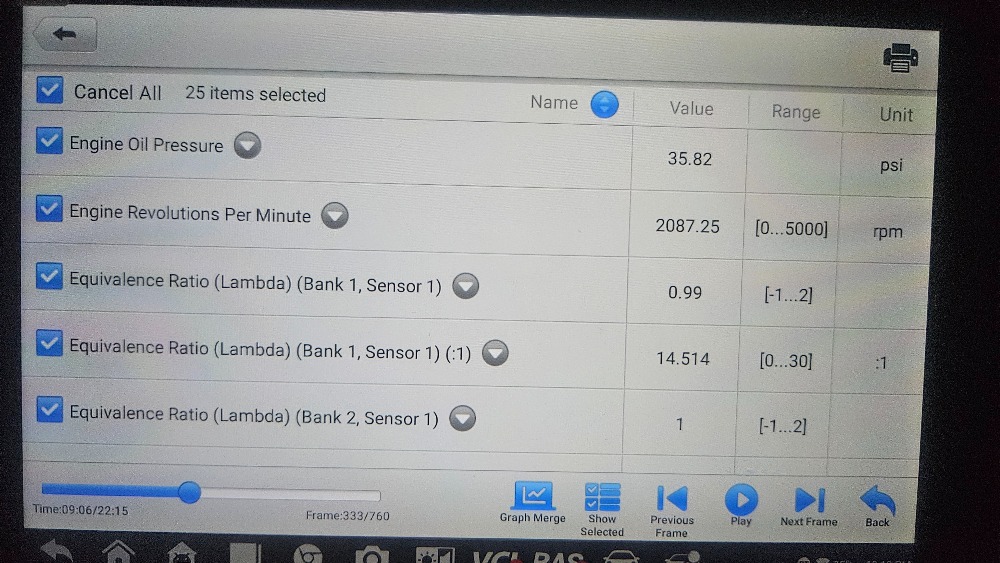

2 years 7 months ago #64927 by 52Tele
Replied by 52Tele on topic F150 No code intermittent misfire issues

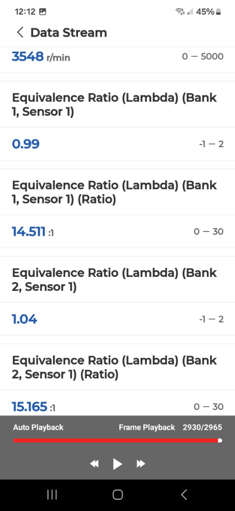

And the last one for tonight parked in driveway at 3548 rpm
2 years 7 months ago #64930 by bills4065
Replied by bills4065 on topic F150 No code intermittent misfire issues
Okay- you have to let us know for sure. Are your upstream O2 sensors wideband sensors? EQ ratio pids are used with wideband sensors. If unsure- clean off your emissions sticker under hood, it tells you sensors installed on that truck. The one graph you posted earlier showed all narrow band sensors. See graphs on post were Noah Thanked You.

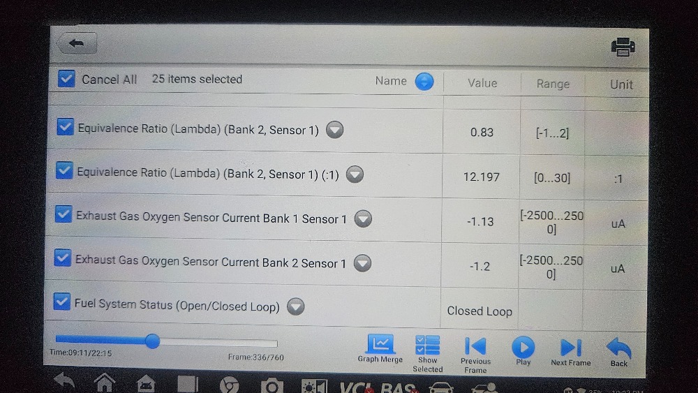

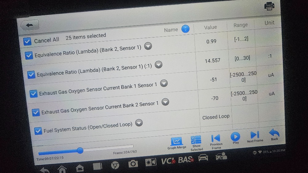

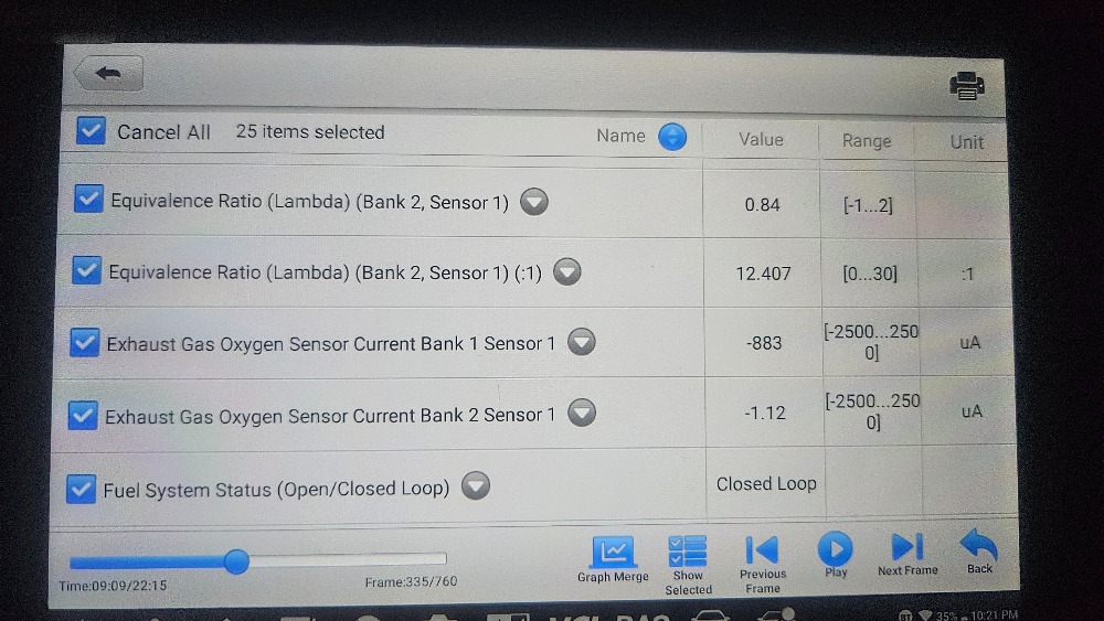

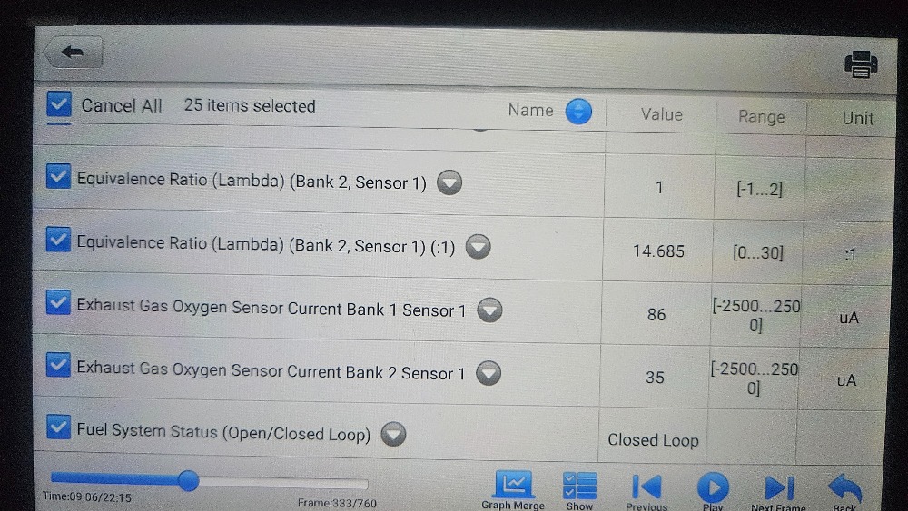

2 years 7 months ago #64953 by 52Tele

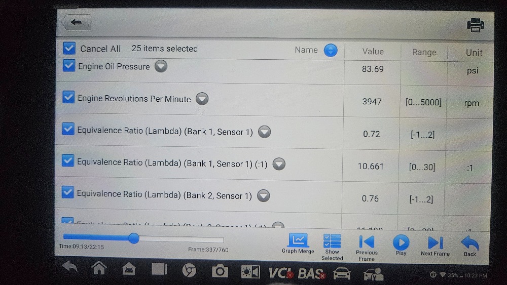

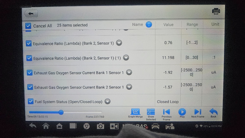

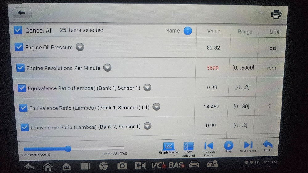

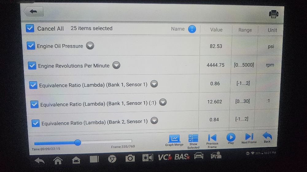

I'll be posting a few screen shots in a moment. So I noticed there are times that the upstream sensors current data comes through as milliamps and other times it's switches to what seems to be voltage. Does anyone know if that is supposed to happen?
  • 52Tele
  • 52Tele's Avatar Topic Author
2 years 7 months ago #64954 by 52Tele
Beginning and after wide open throttle

Sorry this is the after
2 years 7 months ago #64961 by bills4065
Your after screen shots- jpeg 319_022136 of negative 883 microamps. I have never seen that before with a wide band sensor.Do you by chance have another scan tool or can borrow one?
2 years 7 months ago #64963 by 52Tele
Also if you look at the before photo it shows both sensors as uA before I get on the throttle.

2 years 7 months ago #64967 by bills4065
An open heater circuit would flag a code on a wide band sensor. Your "after'' jpeg 319_022353 lambda readings and negative current flow suggest sensors are working at least on fuel enrichment. did the truck have the very rich negative fuel trims at idle before you replaced those upstream sensors?
