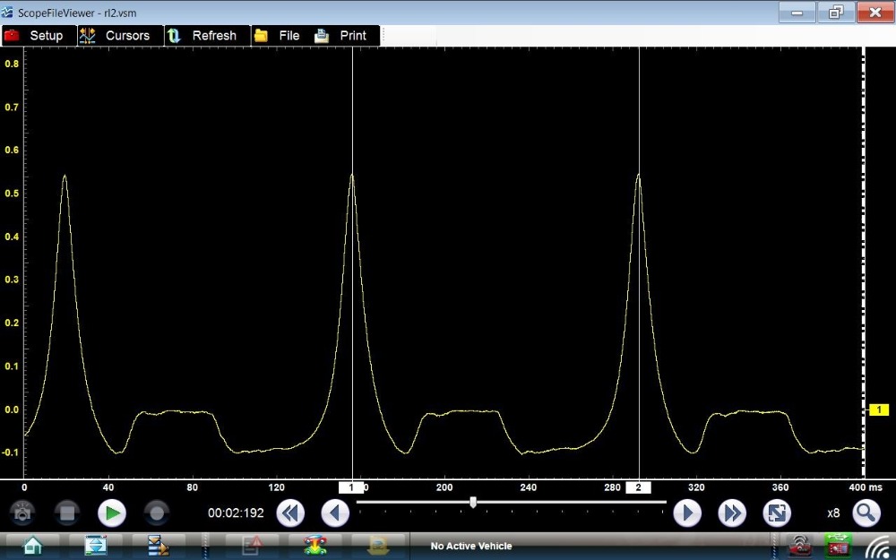

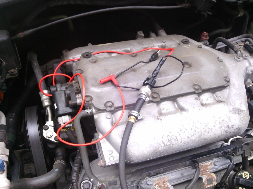

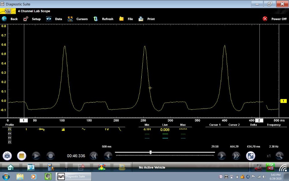

I took an AC pressure transducer from a 2010 Altima, connected the power and ground to a USB phone charging cord I cut the end off of, connected the the cord to the USB port on Verus and clamped it in a compression gauge hose :huh:

Very nice capture.
One interesting thing about the trace is that the voltage is going negative. Looks like the phone charger 0V is floating. Did you use a wall wart or a 12V charger? If it's a wall wart I'm not surprised but I wouldn't expect a vehicle charger to be floating.

The Verus has 2 USB ports on the side.
I used the top one.
I edited the original post to make it more clear.

I just went to double check, the negative portion of the wave form is only when using AC coupling

Noah wrote: I just went to double check, the negative portion of the wave form is only when using AC coupling
So the sensor will only show vacuum while AC coupling? Or will it show vacuum on a normal voltage scale?
6 years 4 months ago - 2 years 1 month ago #40920 by Noah
Replied by Noah on topic Home made in cylinder transducer
It will show vacuum no matter what, it just won't be reflected as negative voltage unless I'm using ac coupling.

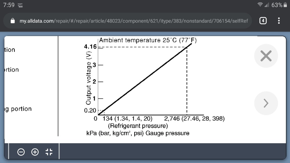

BTW 100 psi doesn't sound right for an AC transducer. Low side would probably be able to go to 200 for measuring static pressure and a high side probably 400 or more.
6 years 4 months ago - 6 years 4 months ago #40926 by Noah
You are correct Matt.
All Data provides the voltage reference chart for the sensor. It appears to max out at 4.16v and 398psi.

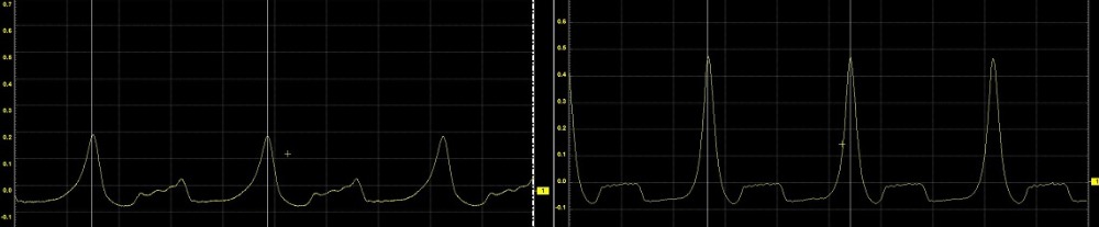

This is from a 2005 Taurus OHV 3.0l
@ idle:

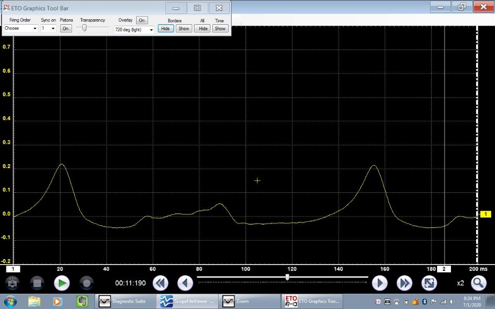

6 years 4 months ago - 6 years 3 months ago #41040 by Noah
Tyler wrote: Now you just need some broken cars to play with
[EDIT: fixed the labeling of the captures in this post to reflect the actual cylinders the captures were taken from. Sorry for the confusion]
I've got one of those. 2001 Honda Accord Vtec 4 cylinder manual.
Customer claims to have been beating on it on the highway, hearing a pop and then heavy misfiring.
He did install a timing belt, because who knows, and then sent it to the shop!
Another tech diagnosed low compression in two cylinders. #'s 2&3.
A leak down test was not performed and the customer decided to junk it.
So here's the data I was able to get after work tonight.

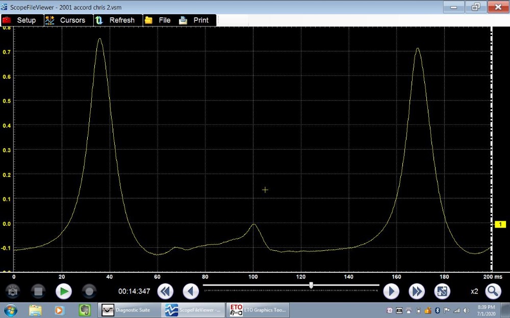

Cylinder 3 with the Focus transducer
Cylinder 2 with the Focus transducer

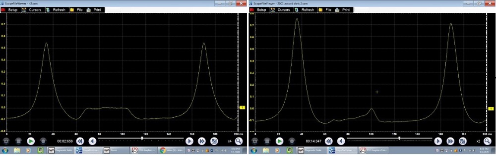

Now unfortunately, I didn't zoom in enough on the Taurus capture with the Focus transducer to make a good side by side of a single 720°
So I made a side by side using the Ridgeline capture, but it's using the Altima transducer. I'll include it anyway since I took the time to make it.
Last edit: 6 years 3 months ago by Noah.
6 years 4 months ago #41041 by Noah
This should be a more accurate comparison, both captures were taken with the Focus transducer
6 years 4 months ago - 6 years 3 months ago #41043 by Noah
The most obvious difference I see is there is considerably lower compression, although the towers appear to be even.
The second thing is the exhaust event.
It looks like it takes longer for the exhaust valve to open than on the Taurus, but that could be a normal difference between the two cars I suppose.
The pressure builds and kind of ramps up at the end of the exhaust stroke but the duration seems roughly the same as that of the Taurus known good capture. Then the cylinder goes into an unequal vacuum compared to what was in the cylinder at the end of the expansion stroke making for uneven pockets.
I wanted to get a known good from cylinder 1 or 4 of the Accord that's broke for an apples to apples comparison, but it won't run on one cylinder, lol.
Any of the experts care to reflect on the waveform and share there their interpretation of what that actually means is happening in the cylinder?

I'm no exspurt by any means but it looks like positive pressure building on the exhaust stroke. I checked to confirm 2 & 3 are both TDC at the same time so I suspect that exhaust stroke pressure build is the adjacent cylinders compression leaking across a blown head gasket.
