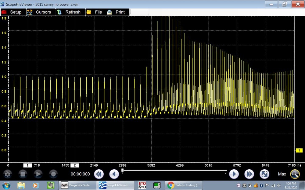

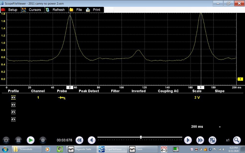

6 years 2 months ago - 6 years 2 months ago #42377 by Noah
Replied by Noah on topic Home made in cylinder transducer

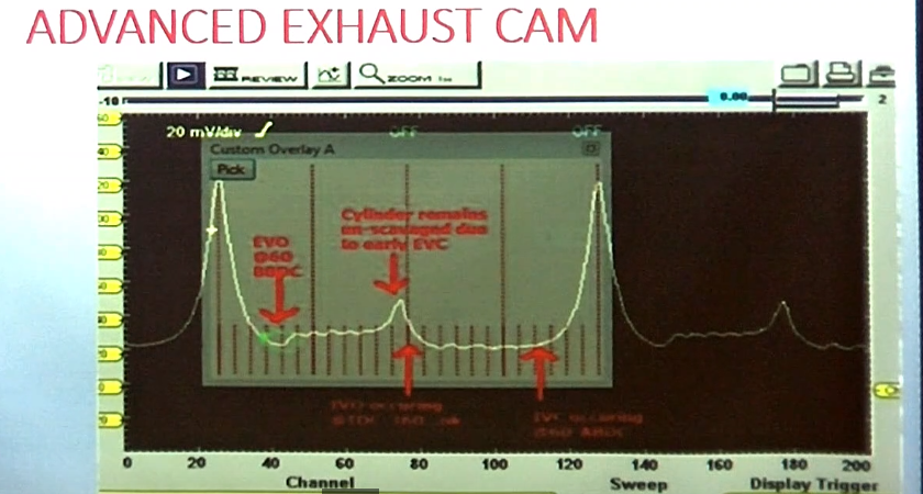

The zoomed out capture is the one that lead to me believe there was a restricted exhaust. The exhaust portion of the pattern grew larger and larger as rpm increased. The zoomed in portion is just for giggles and grins. Taken from the higher RPM portion of the pattern.

6 years 2 months ago #42431 by Tyler
Replied by Tyler on topic Home made in cylinder transducer
That last zoomed out picture really spells out the restriction. B)
Did you happen to save the scan data from your test drive? I'd like to have a look, if possible.

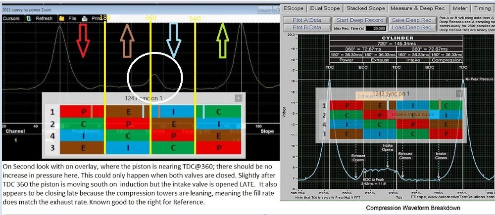

Just reading through the thread here, Noah those in-cylinder captures look like an advanced exhaust cam, not excessive backpressure.

6 years 2 months ago #42649 by Noah
Hi Paul, thanks for checking out my thread. I appreciate the input.
I think I see what you mean.
It looks like the rise in pressure is at the end of the exhaust stroke, like the valve closed early. That did make me scratch my head.
I decided to not pursue timing because the back pressure is confirmed to be excessive with a mechanical gauge, and because this is a DOHC inline four cylinder with a cam sensor on each cam. I figured it would have recognized a timing issue, but I know that's not exactly fool proof logic.
Plus it's not a customers car, so no big deal if it ends up needing a chain set after the cat, the car does have more than a quarter million miles.
I will let you know when we get a cat on it.
I am still quite new with in cylinder wave forms, so I appreciate the insight of more knowledgeable techs like yourself.

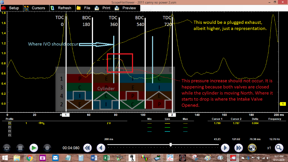

6 years 2 months ago #42651 by Paul P.
Replied by Paul P. on topic Home made in cylinder transducer
Wow, is it ever good to double-check stuff, so long as the engine is not a turbo that little hump at the end of the exhaust plateau should not be there!
The hump is the result of both valves being closed as the piston is ascending nearing TDC Exhaust. Shortly after TDC the piston is descending on the induction stroke, the Intake valve should have opened before 360, but it opens late, then the pressure drops. You can also see it close late at 630 degrees when it should have closed around ~ 585.
I tried to overlay the known good for your reference.
Paul
Never stop Learning.

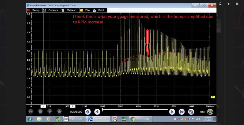

6 years 2 months ago #42652 by Paul P.
Please keep me posted on your findings Noah.I'm now wondering that your mechanical gauge was just measuring those humps which would be amplified with RPM increase.

6 years 2 months ago - 6 years 2 months ago #42653 by Noah
Thank you Paul, I surely will post any updates.
Do you think that that those "humps"at the end of the exhaust plateau measured in cylinder would have been measurable by my mechanical gauge in the exhaust stream?
The only cause for pressure in the exhaust that I have encountered so far is a restriction.
Thanks again for your input and for taking the time to analyze my wave forms.
Last edit: 6 years 2 months ago by Noah.
6 years 2 months ago #42658 by Matt T
Replied by Matt T on topic Home made in cylinder transducer
Weycraze wrote: Please keep me posted on your findings Noah.I'm now wondering that your mechanical gauge was just measuring those humps which would be amplified with RPM increase.
If the humps are caused by the exhaust valve closing early they wouldn't affect exhaust pressure. If they showed up anywhere, outside the cylinder, it'd probably be as pulses in the intake.

6 years 2 months ago - 6 years 2 months ago #42668 by Paul P.
Actually no, Matt T pointed that out, sometimes I get a little ahead of myself. A gauge in an O2 bung would not pick that up. Only an in-cylinder transducer would pick up the restriction when exhaust valves open. Thanks, Matt T!
Now I'll throw this in there if all the cylinders had the same waveform; that would point towards timing ie chain stretch. But if the hump is just this lone cylinder, by virtue of engine design, a lifter issue.
The reason I lean towards timing/chain stretch is the duration of that intake event which I approximated at ~240-50ish degrees which is a very plausible spec, without knowing the true spec.

6 years 2 months ago #42674 by Matt T
Weycraze wrote: Thanks, Matt T!l
You're welcome Paul. It seemed plausible at first glance. Took me "a minute" to catch that the exhaust valve would have to be closed for it to be causing the pressure hump.
The strange thing about this engine appearing to have a timing problem is that the exhaust looks advanced but the intake retarded which seems unlikely unless someone has been in there.........
I think, too damn much :lol: ,there are a couple things which might be making things look strange. First is this engine probably has VVT which might be altering the valve timing??
Second is RPM isn't going to be constant on a 4 banger with a dead hole. Speed will drop during the dead holes power stroke then build back up. So cursors equally dividing 720* between TDC compressions aren't going to line up perfectly with the other BDCs and TDC.
One other thought on the exhaust hump is it might be caused by exhaust vale overlap. The next cylinder opening its exhaust valve while the transducer cylinders exhaust valve is still open. That next cylinder could be causing a spike in exhaust backpressure which gets pushed into the transducer cylinder??

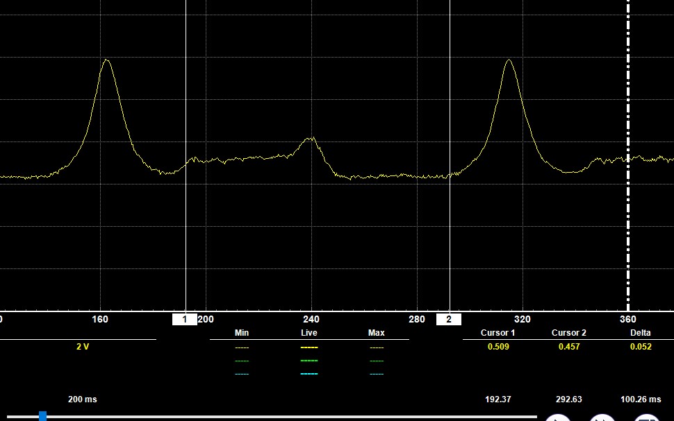

Cam timing looks just as screwed up at idle. But I've found something that could explain it.
2AR-FE motor gained the Dual VVT-i system (variable valve timing with intelligence), driving intake and exhaust camshafts within 50 and 40 degrees accordingly concerning crankshaft angle. What is more, valve overlap varied from 7 to 97 degrees while intake and exhaust duration was equal to 244 degrees.
I figured up the time for 2 x 244* - 7* overlap and set the cursors to it. It seems to fit the waveform pretty good.

6 years 2 months ago #42687 by Paul P.
Matt T, good thinking about the VVT. I do know that the in-cylinder waveform is unique to a cylinder, another cylinder's valve events won't affect that. Intake Pulls and Exhaust Pushes are affected by other valve events.
This is a non-turbo engine, so this hump is preventing 'scavenging' in the combustion chamber. This Rise in pressure at the end of the Exhaust stroke as the piston is approaching TDC can only be because of all Valves Closed.

Weycraze wrote: This Rise in pressure at the end of the Exhaust stroke as the piston is approaching TDC can only be because of all Valves Closed.
Recently I was reminded in another post that we have to be VERY careful with qualifiers like always, never, must be, can only....
There are other possibilities to cause such a rise in pressure, for example a blown head gasket on a neighboring cylinder being on compression stroke. This usually will show up as a rise in pressure in the last 20 to 30 degrees before TDC exhaust in the affected cylinder, depending on the severeness of the leak.
Sure, there would be other symptoms like low compression and it would affect both neighboring cylinders in a similar fashion..
Another variable is a stuck open EGR valve .....

But, that is absolutely correct, based on the cylinder chart in the post if there was a head gasket leak between Cyls 1&2, and 2 was on the Exhaust stroke, 1's Power stroke would be evident exactly as you describe.
So there definitely are other variables.
Interestingly enough, the waveform sure matches this one; but that would really depend when EVO occurs.
