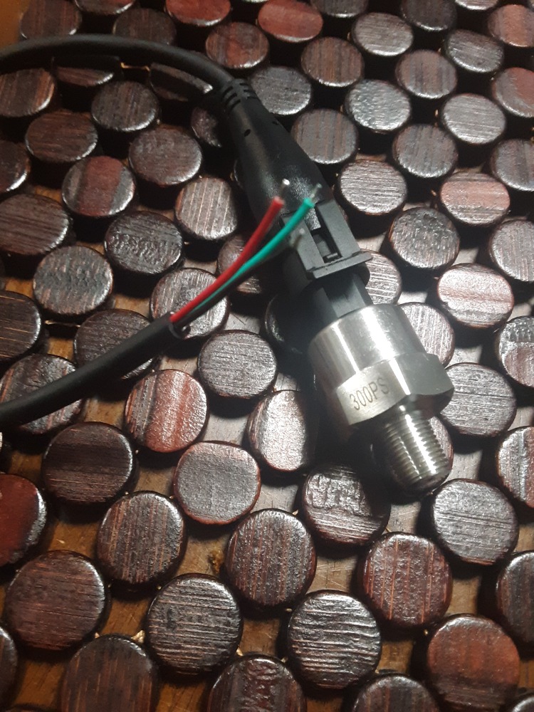

I did find a brass coupler to marry it to my compression gauge but I think I'm abandoning the refrigerant pressure sensors.
The voltage output at rest is too low to use the pressure scale on the Verus. I ordered the same one (presumably) that Paul has had success with. The seller claims it to have a range of .5-5 volts.
All mine put out .012 at rest.
If faced with the prospect of spending several hundred dollars on a transducer set up, you better believe I'd just live with this setup on a 2v scale, measurement be damned. But for under $20, I'll give this a try.

The first testing with the new sensor is a bit disappointing. When compared to gauge pressure it is 5psi off (positive) around 5 psi and deviates proportionally as pressure increases. So 80psi gauge pressure is more than 100psi on the scope scale.
Looks like a proper 500psi & 100psi sensor is in order to properly use the pressure scale.

The sensor seems to have been damaged. It now outputs 1.5v at atmosphere and will not calibrate to use the voltage scale built into the Verus.

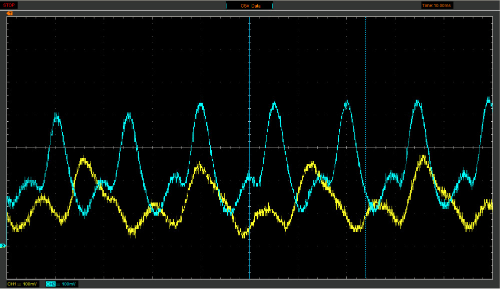

6 years 2 months ago - 6 years 2 months ago #42366 by Noah
Replied by Noah on topic Home made in cylinder transducer

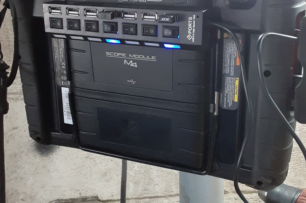

Matt is going to love the newest addition to my scope ;)
I got tired of losing my mouse or keyboard dongle to capture in cylinder or vacuum patterns.

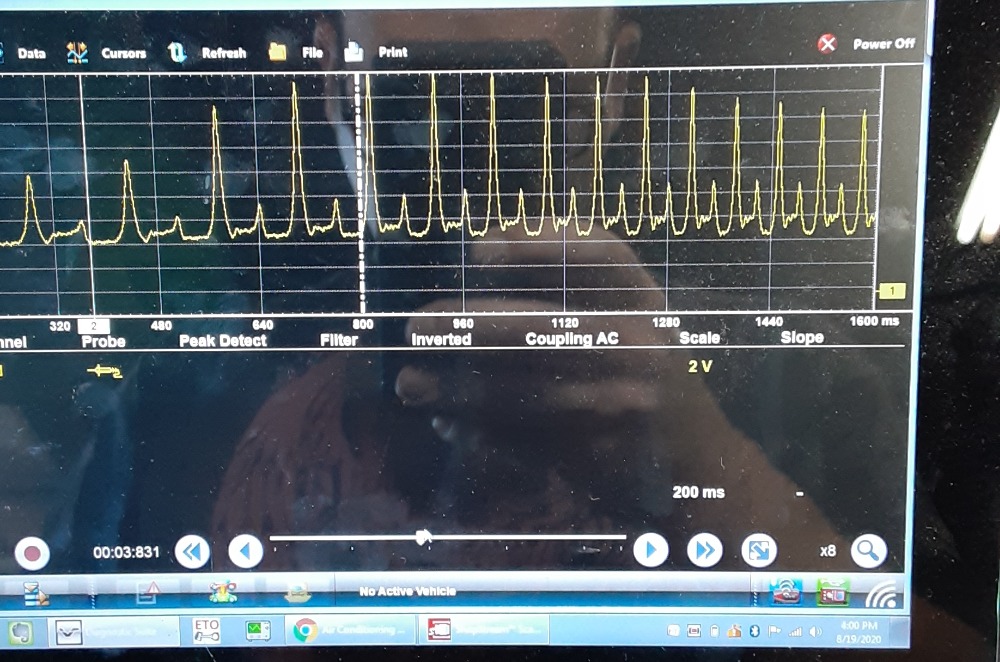

I also caught a Camry with a restricted catalytic converter using one of my homemade transducers:
Before I realized the Amazon sensor was garbage a gave the transducers I had made to Tyler, so I rigged one up quick to diag a no power complaint that one of the other mechanics a previously looked at. He pretty much drove it with the o2 sensor out of the manifold (with no improvement) and bailed.
I've never had luck with that "test".
That mechanic has been there 20 years, so the boss doesn't believe me right away when I present him with conflicting diagnosis.
Since the o2 had already been removed, and since this was my first suspected exhaust restriction using the in cylinder technique, I backed up my data with a good old gauge.
2psi @ idle and maxed out on the pressure scale on a rev in neutral.
I'll upload a cleaner capture from the Verus today, but the pattern is very similar to what I got from the Accord with the "bad engine".

6 years 2 months ago - 6 years 2 months ago #42367 by Matt T
Replied by Matt T on topic Home made in cylinder transducer
Noah wrote: Matt is going to love the newest addition to my scope ;)
You can run transducers on all four channels now :lol:
Noticed the USB symbol on the back of that 'scope module. Didn't realize you could run it detached from the scan tool.
www.snapon.com/Diagnostics/US/KB/Using-t...4-Meter-Remotely.htm
Noah wrote: I also caught a Camry with a restricted catalytic converter using one of my homemade transducers:
SNIP
The trace definitely shows exhaust stroke pressure increasing with RPM. The pressure "spike" at the end of the exhaust stroke looks similar to the Accord. Is the Camry also an I4? Also what was the complaint on the Camry? Just low power or rough running?

6 years 2 months ago - 6 years 2 months ago #42368 by Noah
Camry is a 2.5l I4 DOHC. 254,000 miles, no power but idles well. No codes.
Test drive revealed that o2s went rich under full throttle, load was high (EDIT: Calculated load was 100% for the duration of my wide open throttle pull.
Absolute load touched 100% at tip in, but quickly dropped to around, and remained near, 55%.), so I skipped fuel delivery and decided to revisit exhaust back pressure.
