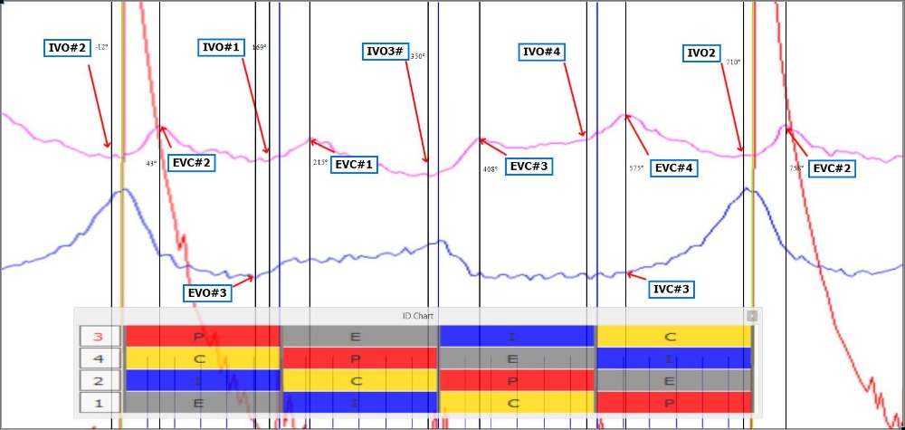

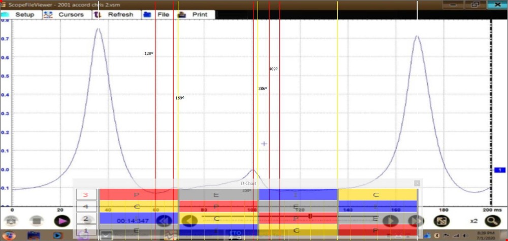

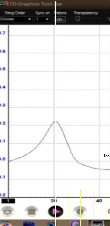

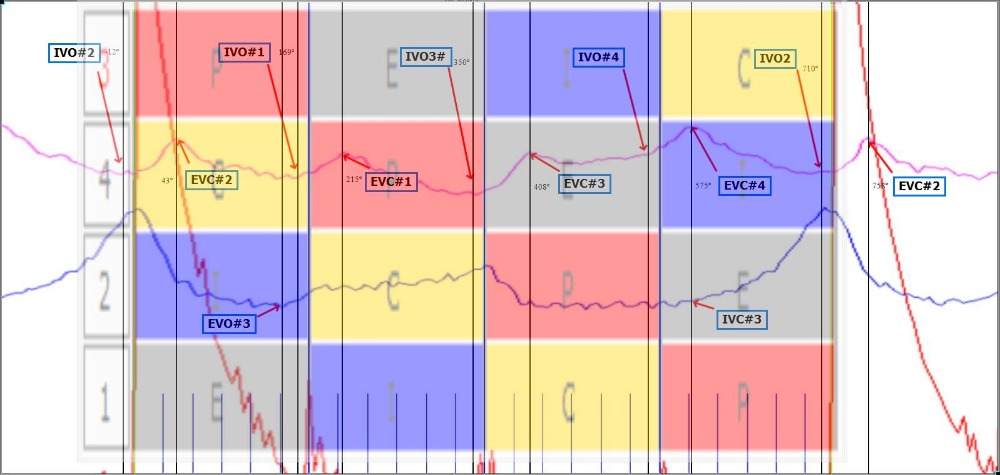

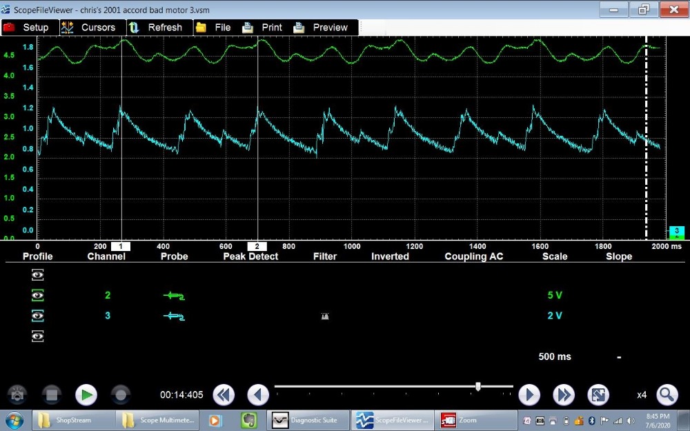

Replied by juergen.scholl on topic Home made in cylinder transducer
You'll need an intake manifold pressure capture and, if possible, an exhaust capture as well... You might get an intake capture from the map, if present. A snap throttle capture would be helpful as well.
Cyl #4 got a massive leak, somewhere;compression towers are shifted. some valve events on #4 seem to take place later than on #3. Both cylinders can not evacuate the exhaust gas properly. The pressure build up in #4 both on the exhaust ramp as on the compression stroke does show a very rounded curve....
It looks to me that the exhaust is partially clogged, affecting both cylinders. Furthermore the #4 intake valve does not close properly.
I attached some pictures with rulers...

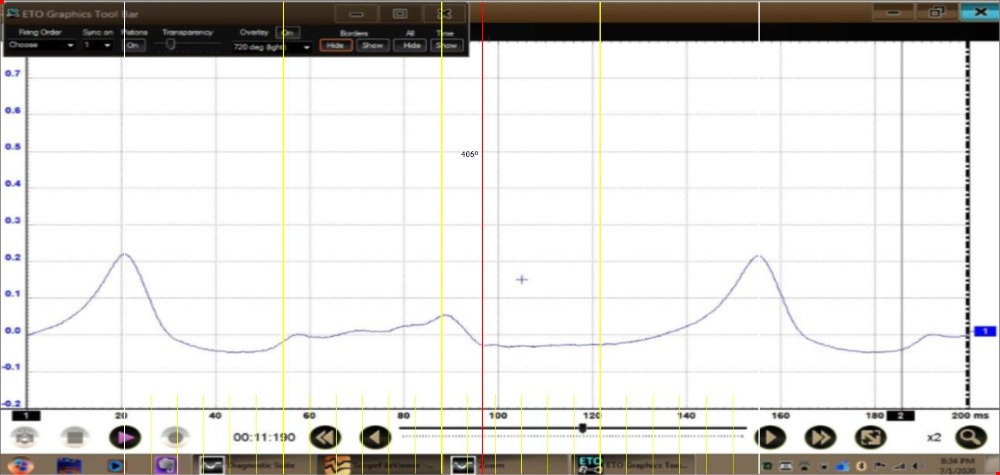

Noah, could you confirm whether these traces are from cyls 2 & 3 or 3 & 4. I thought the trace labelled 4 was a typo because it didn't match everything else you'd written. If it is 3 and 4 that'd make Juergens exhaust back pressure explanation more likely than my guess.
6 years 4 months ago - 6 years 4 months ago #41064 by Noah
Replied by Noah on topic Home made in cylinder transducer
They are labeled incorrectly, that's my bad.
The cylinder with high compression is cylinder#2, the lower compression cylinder is #3.
I attempted to collect a capture from #4 but it won't run on one cylinder.
I get out early today so I'm going to try to make a sensor to put on the intake unless something else comes up.
Thanks for the feedback guys!

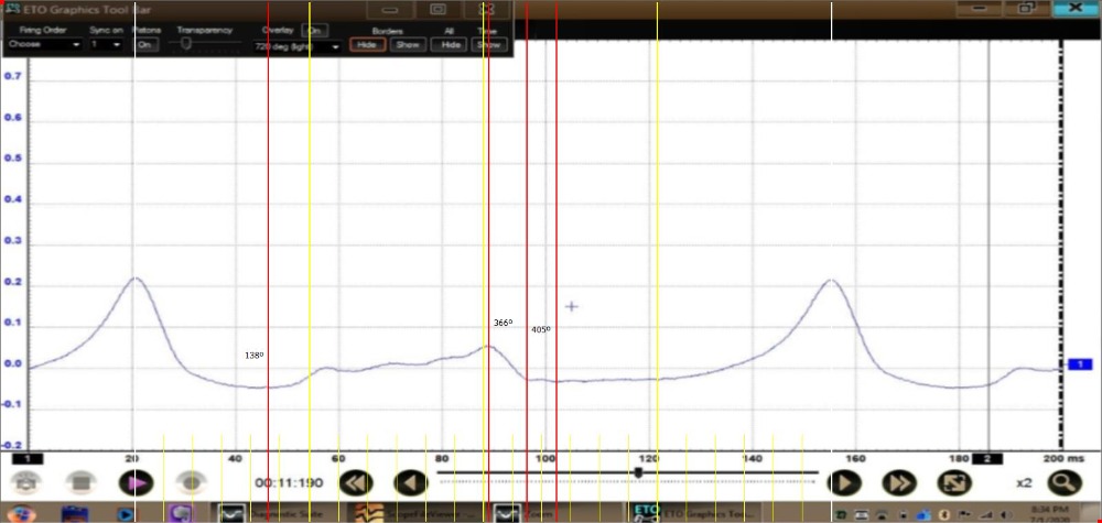

6 years 3 months ago - 6 years 3 months ago #41091 by Noah

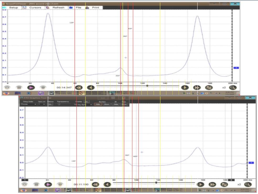

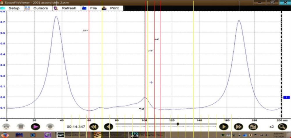

Thank you for taking the time to give an in depth look at my captures Juergen, and I apologize for not having them labeled correctly.
It's very helpful for me to have your insight.
I agree with your assessment of the exhaust not being able to leave the cylinder quickly.
The fact that it takes a long time for the exhaust to reach atmospheric coupled with the fact that both cylinders look similar in that regard makes me wonder if the DIY timing belt replacement could have installed another problem after he broke the car beating on it.
Do you think that the exhaust pressure displayed could be accounted for by incorrect cam timing, considering it is common to both cylinders, or is there something else in the capture that might indicate this is not the case?
Just so we're all on the same page this is a single over head camshaft design.
Using AC coupling puts atmosphere @ 0.03v. I am roughly at sea level.
The actual running compression of the known good Taurus was about 75psi according to my mechanical gauge.
Just to give an idea of the voltage to pressure scale.

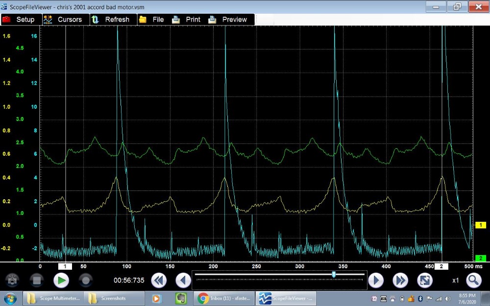

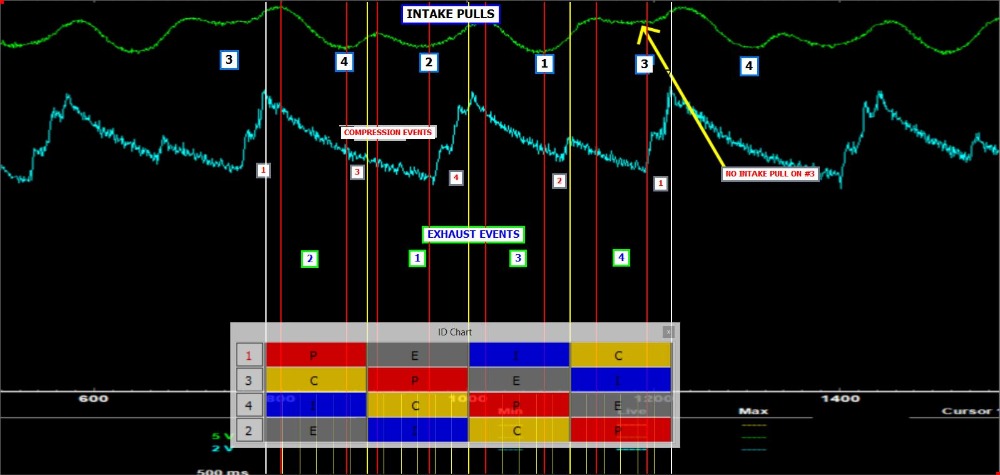

I had a little time after work to play with the Accord and some pressure sensors.
I tried a GM fuel tank pressure sensor, but wasn't immediately impressed. I ended up with a GM MAP sensor, so its an absolute pressure sensor, high voltage is BARO, low voltage is vacuum.
The first capture is engine cranking closed throttle, relative compression & intake vacuum. There is no appreciable in cylinder waveform during cranking so ch1 was turned off for this capture.
Next up is a running capture featuring intake manifold vacuum, in cylinder compression on cylinder #3 and ignition sync #3

6 years 3 months ago #41136 by juergen.scholl
Both cylinders # 2 and #3 lack compression. #3 shows no resistance at all to the starter motor while #2 seems to have a little bit of compression. Because of the massive leak I believe that the pressure peak of #3 dos not coincide with the actual TDC. The intake pull for cylinder #3 is completely absent but the valve does open and it does not leak into the intake manifold. The intake valve of #2 doesn't leak either into the intake manifold. The valve timing seems to be correct. ( With the engine running the exhaust valves of the bad cylinders seem to close 10 degrees later than the better ones but I think this is due to difference in rotational speed because of the deficient compression.
I'd love to see a a cranking exhaust pressure waveform, maybe you can take one?. Although the two bad cylinders are adjacent it does not look to me as if a blown headgasket causes one cylinder to evacuate into the other; in this case I'd expect both cylinders to be afffected in a more similar way....
You may want to try to AC- couple the MAP sensor in order to gain a higher resolution.

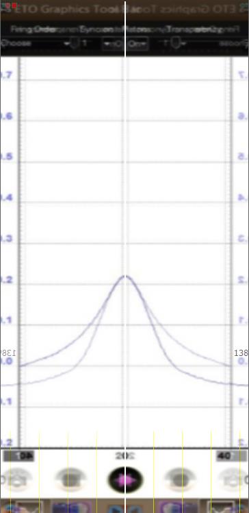

With the vacuum sensor AC coupled it behaves differently.
Instead of outputting a linear voltage, the waveform looks more like a differential sensor. If I have the opportunity after work to play some more I will attempt to gather some exhaust patterns.
Again, thank you for taking the time to look at my captures and share your knowledge.
This kind of testing is new to me, but I would very much like to understand it enough to start incorporating it into my routine.

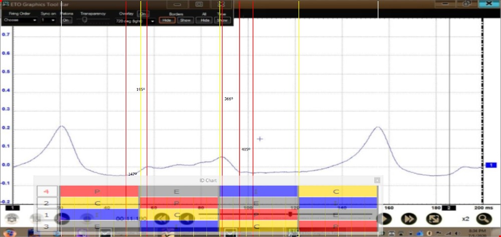

I'm still digesting your analysis Juergen. I'm just starting to learn how to apply the over lay software and calculate degrees of rotation to valve events. The ones that you applied to the In cylinder captures are very helpful.
Nice job picking out the firing order on the relative compression & vacuum wave form.
I really should have used an ignition sync.
I honestly expected to see a greater compression hump from cylinder #2 based on the in cylinder pattern from #2.
It looked pretty regular while running compared to the couple of known good captures I have from the Taurus and my Ridgeline. Could the use AC coupling be skewing the captures?
Of course running compression is lower than cranking, so that must be the reason for it but for me it was unexpected. (I was secretly beginning to doubt the previous techs cranking compression test results after seeing the in cylinder for the first time)
Another thing that I was thinking about was the low compression on cylinder 3 coupled with the lack of an intake pull for the same cylinder. Is it possible that the intake valve does not open, resulting in no air to compress ultimately resulting in no compression? I know you said that cylinder 3 has a massive leak, is that based mostly on the low compression towers or is there another indicator that I am not seeing?
Once again, I greatly appreciate your help in understanding the results of these tests.
It will be fun to make a hypothesis and then prove or disprove it before the car is junked.
