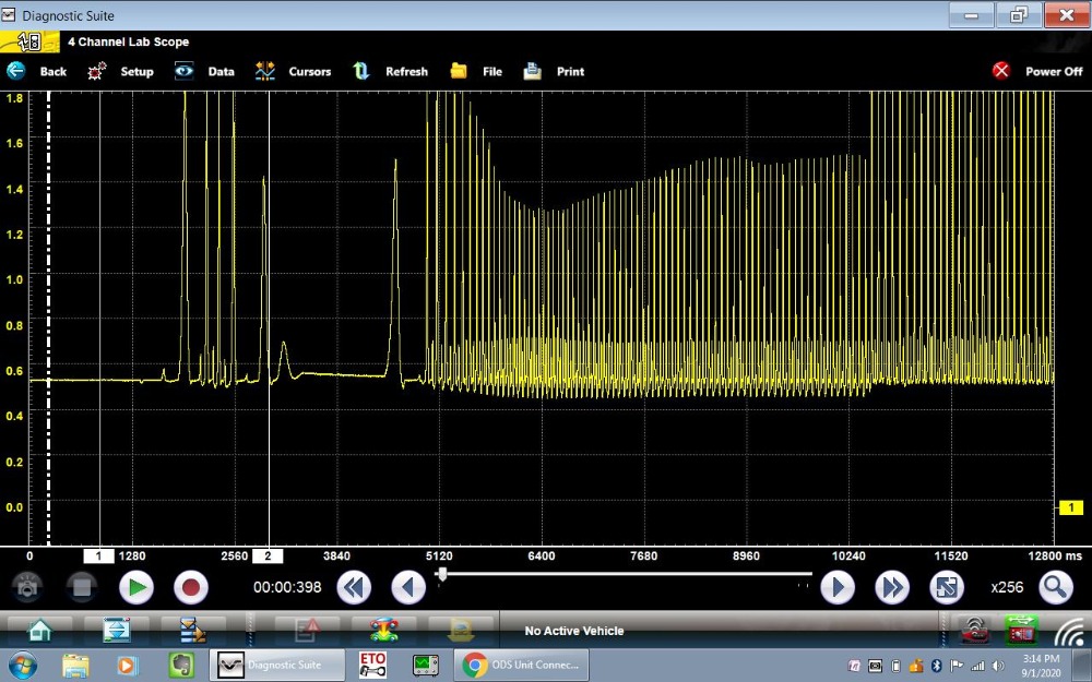

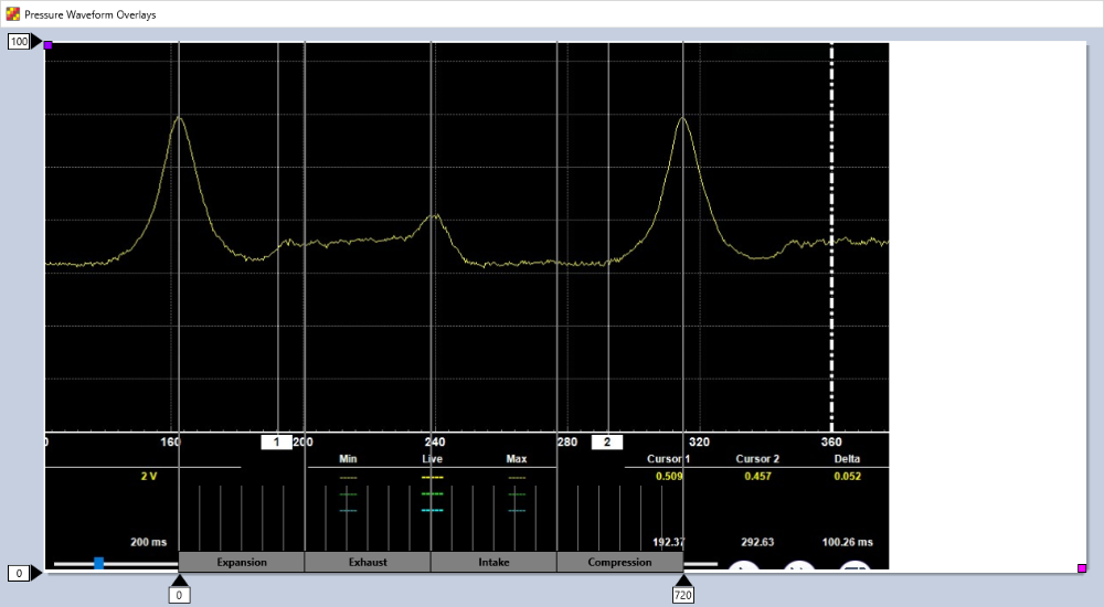

The Camry had it's turn in the shop today.
This is the capture taken in cylinder after changing the cat:
You can see that through the over all range that exhaust pressure remained steady. A great improvement over the other cat.
Gauge pressure confirmed the restriction had been removed.
However, power was not restored. So, in the eyes of the boss-man and the other mechanics, I blew the call.
Whatever, the cat was clogged, it just wasn't the whole picture. The car is just a junk auction clam, so there's no pressure and no customer to answer to thankfully.
Then it gets extra stupid...:silly:

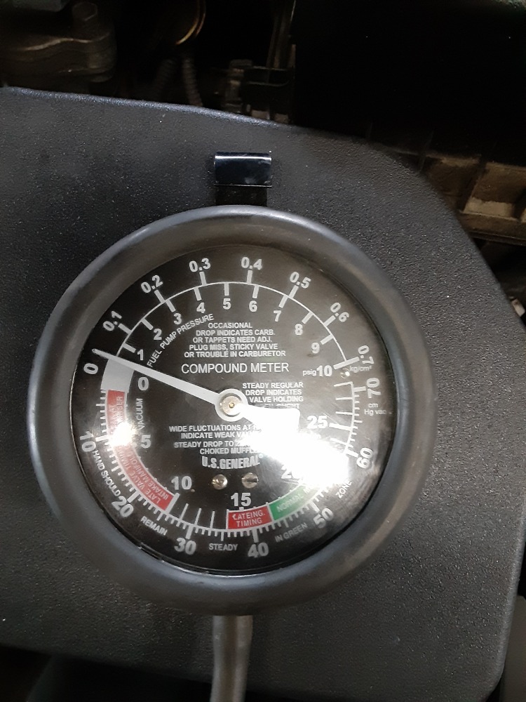

I installed a fuel pressure gauge to appease the boss. Fuel delivery isn't on my list of suspects based on my prior test drive data.

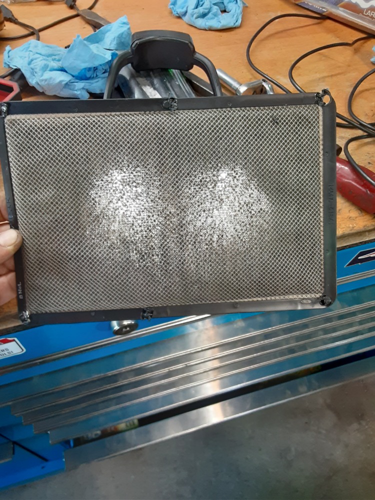

To T in, i removed the entire snorkel, MAF, filter, etc.
It didn't want to run, but i managed to give it the magic boot and noticed that after a bout of bucking and farting that it was free revving better than it ever had :S ...
I removed my pressure gauge, installed the air cleaner assembly and suddenly the car has 95% more power.
I don't know what changed.
I cleared the codes I had set thinking maybe it finally decided to ignore the MAF, but that was not the case.
This is not the gratifying outcome I was hoping for.

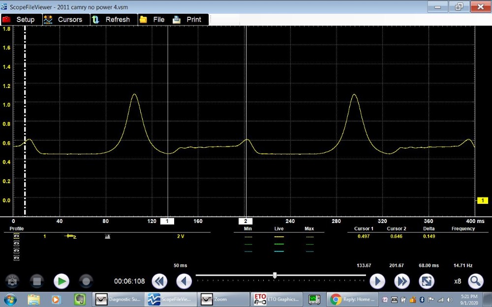

This the in cylinder idle waveform as it is now.
There's still the tail at the end of the exhaust plateau that suggests the exhaust valve is closing too early, but you can actually drive the car now, and I'm not sure why. :S
Last edit: 6 years 2 months ago by Noah. Reason: Add pic of gauge

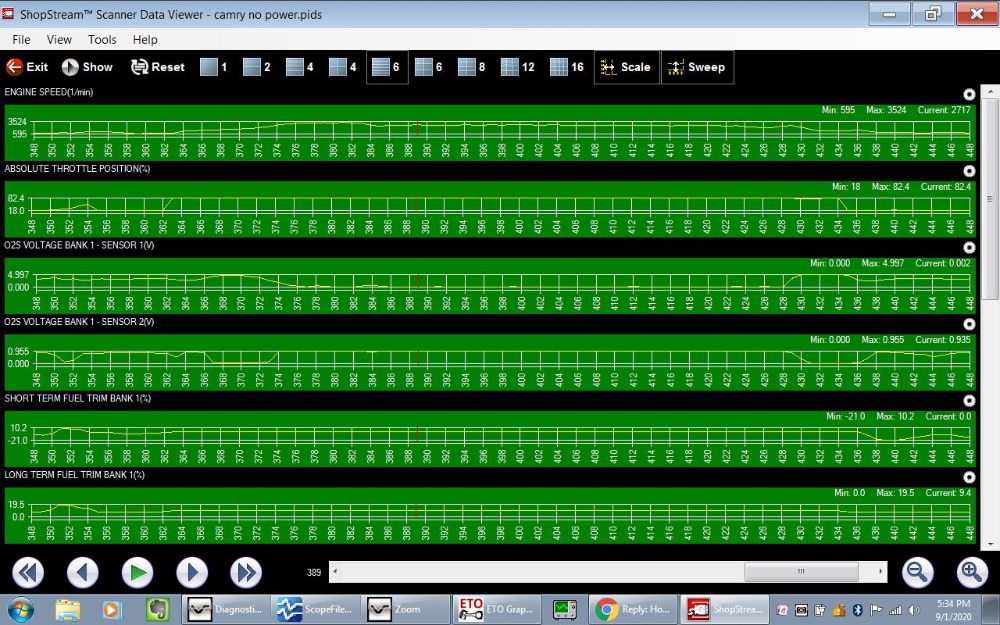

You may have fixed a restriction somewhere in the air intake. Do you have MAF and MAP PIDs in your pre-fix scan data?

I wondered the same? :huh: But I looked back at the first in-cylinder capture. If 500mV is atmospheric for his sensor, and the lowest that the intake pull went to during the WOT snap was right at 500mV, then that would suggest the intake was truly at atmospheric pressure.
A restriction that was screwing with airflow across the MAF, maybe? But then why did the upstream A/F show rolling coal rich during the WOT test drive? :silly:

Is it possible that the air filter was/is coming apart and restricting the airflow?
I once experienced this on a Ford F150 where the plastic cone came off the filter. The car would bog down on heavy accelerating/WOT as the cone was sucked into and blocking off the air.
6 years 2 months ago #42711 by Hardtopdr2
Replied by Hardtopdr2 on topic Home made in cylinder transducer
Could just be carbon buildup on the intake side of valves due to the backpressure pushing back into intake with the plugged cat. Time for some seafoam or pop intake off and clean intake runners and valve ports with some cleaner.
6 years 2 months ago #42712 by Noah
Replied by Noah on topic Home made in cylinder transducer
juergen.scholl wrote: Is it possible that the air filter was/is coming apart and restricting the airflow?
The air filter looks to be brand new-ish.
There was this bit of under britches integrated into the lid of the filter housing assembly.
And there were some leaves in the bottom of the box, pre filter, but I don't think either one explains the change in symptoms.
It still barely ran with all of that off the car until I gave the throttle a right boot work out.
I returned said under britches to it's place in the filter box and it still runs just the same.

One quick thing you could do is have a look for camshaft position PIDs. Might tell us whether the cam timing is screwed up or something the PCM is doing.
Another would be to put a transducer in the O2 sensor bung to see if there are any pressure pulses which could be affecting the in cylinder waveform. Best to do this with another transducer in cylinder but if you don't have two of them an ignition sync would be good enough.

The EVO is advanced, but it's closing almost on time. This to me can be an indicator of valves out of adjustment. A tailpipe waveform tailpipe waveform along with the in-cylinder could confirm this. But the opening early with the spike does look like an advanced cam. Pretty nice capture with that sensor.

John Curtis wrote: The EVO is advanced, but it's closing almost on time. This to me can be an indicator of valves out of adjustment. A tailpipe waveform tailpipe waveform along with the in-cylinder could confirm this. But the opening early with the spike does look like an advanced cam. Pretty nice capture with that sensor.
Thank you for your insight! Now that the power has been restored, I haven't been afforded the opportunity for much follow up testing. I do have some test drive scan data that isn't very revealing (vvt PIDs don't respond, I'm told that's a common snap on thing with toyota).
I'm very pleased with the waveform that sensor produces. I bought 3 sensors on Amazon thinking they would be better but the resolution doesn't even come close.
