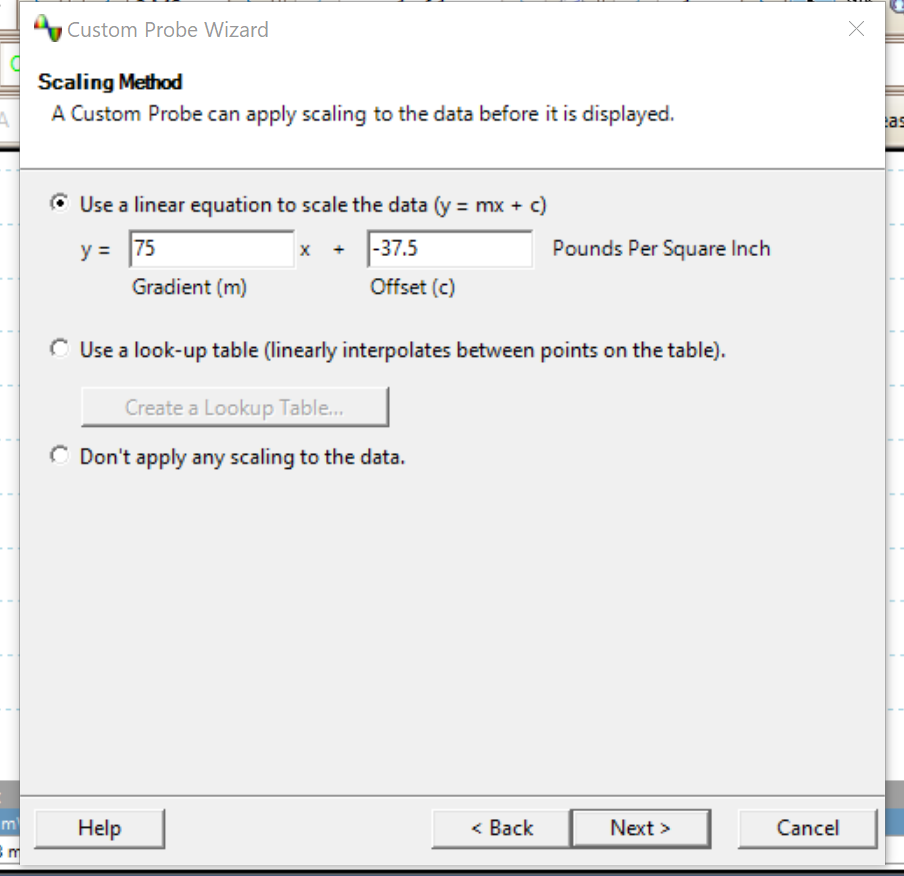

The setup I have works really well, it's a 300psi transducer, and measures vacuum if the correct calculation is put into pico custom probe settings. I just need to figure out how to lower the setting by 2 psi. That's all

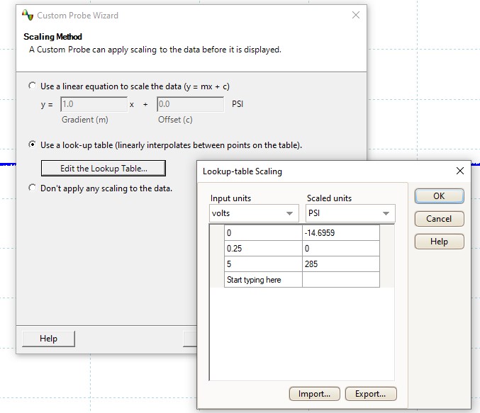

Try using a lookup table. Numbers I threw in are guesses for a 300 PSIA 0-5 V transducer. You'll have to adjust the voltages in the table to match your transducer. Also bear in mind that if you do have an absolute transducer the PSIG zero will drift around a bit due to changes in barometric pressure.

This is the Linear equation I used for the 300psi transducer so I could use it for incylinder. That way I can see the vacuum pockets, it's just about 1.8psi off. I just need it to read zero at atmosphere. I can see incylinder waveforms with this equation great. I watched a video about setting the custom probes using a look up table with a 5 volt sensor, and it instructed to want to set your 0 psi at 0.5v and your max psi at 4.5v. Here's the video about that. I set my 80psi transducer by this and it compensates for atmospheric pressure I guess is the reasoning behind it
